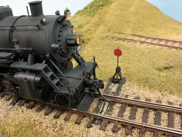

I used WS fine light grey. Very pale and hard to photograph, but it stains nicely.
Looks ok to me, but I know nothing about ballast!
At least it might help you decide.
Mike

Mark - I poured the ballast from an eggcup. I found the ballast so lightweight that I had to gently pre-mist it with water that had a dash of detergent, before carefully using an eye dropper to add diluted PVA glue. The misting had to be done with a very fine sprayer so that it didn’t move the ballast.
I used an old pump action room deodoriser. I also used a soft paintbrush to tidy it up before it got wet. Once the ballast was wet I found it clung to the brush, so there was a fair bit of tidying up to do after it had dried.
It was a fiddly job.
When it was good and dry I stained it with acrylics. Makes me wonder why I didn’t start with a darker ballast [:)] But I do like the pale colour to start with.
Mike
