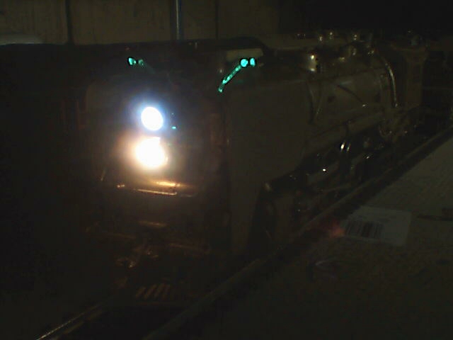

Update getting the marker lights working on the Nickel Plate Products NKP 4-6-4.
The colors can be changed to red/green/white/yellow, only RGW needed here.
I have been working on the number boards, no pics yet, some tries and fails and successes came down to using a micro-LED premounted on a pc board and placing it inverted in the hollowed out Rivarossi NKP number board. Not using the original brass ones.
Its close, I have numbers almost ready to mount, so pics may be soonish, the ordeal is coming to light now and not bad looking. Its a learning curve and I still think improvements can be done, but a good result is coming out from these efforts. Above pic was done weeks ago but couldnt get on here.
New pics fairly soonish.

Well done! We will look forward to your updates.
I have a similar project underway right now. Thanks for the inspiration.
A few detail shots of how you are doing the number boards would be very helpful.

I presume you’re operating TTTO. "Second or more sections following?
Actually, you need green, white and black* on those classification lights. Markers (red-green or red-yellow) would only be shown in that location if the locomotive was proceeding tender-first, either running light or as a rear-end pusher.

  • Why black? Because a train running as a single section (or the last section of a train running in sections) did not show marker lights or carry flags. (Since every train I run has its own dedicated timetable slot my locos don’t even have brackets to hold marker lamps. Sections and extras just don’t happen in Japanese practice.)

I am using Champ BugBoards (white on black) for the numbers, I laid one on cardstock, worked but tried the next, had problems, so I found some translucent plastic (thin white plastic sheet) to put the decal on, thats more reliable and enough light will get through. Champ is out of business now, but I found a new source for bugboards.

Its not possible to get a red/green -red/yellow here (but I am running 2 fibres up to the lamp, would have to add a 2nd LED) so an adaptive to the rules would be accepted.
I am using the QSI Titan decoder, but a function decoder can do this as well in tandem to other decoders.
I don’t think that even if running backwards the marker lights would be displayed where the classification signals are. Diagrams that I’ve seen in rule books during the steam era for a steam engine running backwards show the display of the proper class signals in the usual place and the marker lights carried on the pilot deck.

if you had to do an extended backward manuever and the engine front is the rear of the train red markers will be displayed. Running light you may put white markers up on the tender.
depending on operating circumstances if moving a cut of cars and no caboose on rear you may pop a fusee on the coupler. That would be interesting today with these micro LED’s and teeny batteries you could simulate fusees.
