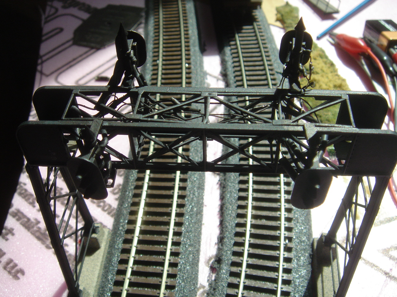

I installed two signal heads on the silver spray-painted bridge. Looked great! I tested them- my LED test jig is a 9V battery with a resistor soldered to one terminal. Great … But! I accidentally touched the non-resistor terminal to RED of one of the heads. Puff … The REDs are super sensitive, I think the Green survived. Do you guys have similar experience? Delicate work is so frustrating.
I am also finding that soldering is hard on this delicate structure. I might have to get new tips for the soldering iron …
Tonight will be another try. I will try to upload progress pictures- you will see it is a very simple signal bridge, but it looks ok actually.

Here are the materials:
Two posts and the bridge lattice beam cut to size and with notches added for mounting signals. Two signals: one is prepared with the head off and one is still in the as-purchased state.
Here is the bridge with signals mounted. I was pleased with ths until I took out the RED from one of them and the soldering part got frustrating.

Are you positive,that the signal lights are LED’s and not,1.5 volt bulbs??
Cheers,
Frank
Yes. The only work in one bias and everything about the lens and the light pattern is LED.
NP
NP,
The reason why I asked,was that you said,the Red one went poof,when you touched the lead without a resistor with a 9volt Batt…12volt or 3volt,LED’s in the signal head??
By the way,in your pic,is that Warren Truss Girder you show,is that from,Plastruct??
If they are,those surely,are not cheap,how well,I know that…I spent more money,detailing a interior roof,on a Machine shop,than I paid for the whole kit…
