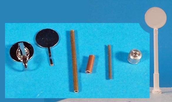

While rehabilitating an old N scale gas station model to sell it off, since it did not fit on my present layout, I discovered the corner gas company brand sign was missing. It had a distinctive shaped sign and I had a decal for the sign, but did not know if I could neatly scratchbuild the odd shape. However there were other decals for the brand that would fit a round sign, if I could make one neatly. The solution was a craft store clip-on earring blank. I bought a package of a half dozen years ago for another sign project, and had several left over. (shown at left) And it perfectly fit a round oil company sign. Removing the clip and straightening out the stem of the clip gave me a neat metal circle with an integral “handle,” a lollipop shape. I found a piece of brass tubing that the lollipop “stem” fit into, and a piece of copper tubing that fit around the brass tube, and a piece of hard steel wire that fit into the brass tubing. The steel wire would fit into some kind of a fitting I got as the hardware store to use as the base. All assembled with GOO™ and superglue and 5-minute epoxy, I had a nice structure for a round sign.
I wanted to check the color of the pole so I googled service station pictures from the 1950s. They ALL had the distinctive shaped sign. I redoubled my search through my surplus structure box and found the prototype-shaped distinctive sign. I put my sign structure in my surplus sign parts box. It had been fun and I learned a little something.
