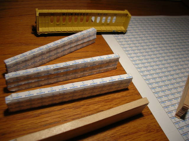

I took a famous logo Domtar - mucked about with it on excel ( cut/paste - cut/paste etc ) - printed it on label paper. Then merely wrap your wood - Worked great ! Here’s a quick example of this technique.

Here is how some of them turned out.
N-Scale Lumber wraps
