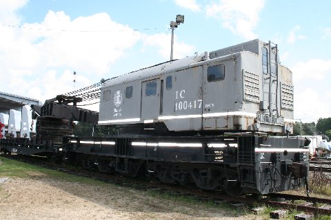

Just a thought on this, The ICRR Museum at the Station area in McComb, Mississippi ( Has on display a 250T Industrial Brownhoist RR Wreck Crane) as part of its collection… it seems to be in pretty good shape…makes me wonder if it may be a "loaner’ from the RR… McComb is still a pretty important place on the CNR ? It is ICRR #100417 and its tool car (see photo:
linked @ .http://www.rypn.org/forums/download/file.php?id=2097&sid=3cac16738c29725f7d61bd0463f6b47e
Cranes in a museum may still be operational, but that does not mean they can be used quickly. All the inspections have to be up to date. The usual railroad aspects are routine, but I believe ALL the cables need to be inspected regularly before the crane can be used to lift anything. And by all the cables, that means every inch of every cable, not a simple task. A snapped cable can be lethal for anyone in its path, and a dropped load is no better.

Confusion seems to reign. Not that I follow this issue closely, but it apparently isn’t the first time there have been problems reported with the Canadian Trackside Guide. Here it what it shows:
ICG 100415 is a 150T crane @ McComb.
ICG 100416 is a 250T crane location unpublished. The one I mentioned above.
IC 100417 capacity and location both unpublished.
It would appear we should go with the photographic evidence.
