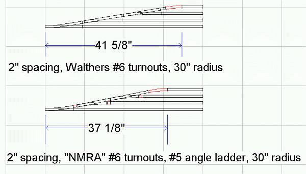

Trimming turnouts and/or using turnouts constructed with shorter “leads” also makes a difference, even for the same number turnout frog. For example, here are two 4-track ladders contructed with 2" track-to-track spacing, #6 turnouts and 30" radius curves in HO. Using a more compact #6 turnout (here, the NMRA #6 which is used by the FastTracks jig) allows the use of an an angled ladder track – which results in more than a 10% length savings over 4 tracks. Note that the Walthers #6 turnouts could likely also be trimmed to length sufficiently to allow use with a #5 ladder angle, but I don’t have one handy to be sure.
Just an example of a case where generic “rules of thumb” don’t necessarily apply.

Nice specific example, Byron.
But Paulus’ rule is, in fact, precisely correct for each additional track in a ladder, once the first turnout and the curved piece of track which makes the last yard track parallel are in place. So in Byron’s examples, making the yard a 5-track yard would lengthen the #6-ladder yard by 2*6 = 12 inches, and the second, #5-ladder yard, by 10 inches.
Running this calculation backwards, the length for the turnout and curve section for the first additional (i.e., the #2) yard track with a #6 ladder is 41-5/8 - 212 = 17-5/8", and for the #5 ladder, 37-1/8 - 210 = 17-1/8", showing that you don’t save anything with just one siding - think about it, the only turnout is still that first #6.

hi The trick Byron Henderson explained was about using #6 switches in #5ladder. The greatest problem is the S-curve.; but only if you go to track 2. You can also use two switches in the main. The first one goes to track 3 and beyond and uses Byron’s trick. The second goes only to track 2 and could be a #7 . I never tried using #6 switches in a #4 ladder; i’ll try it out with some photocopies on the floor. good luck and have fun Paul
