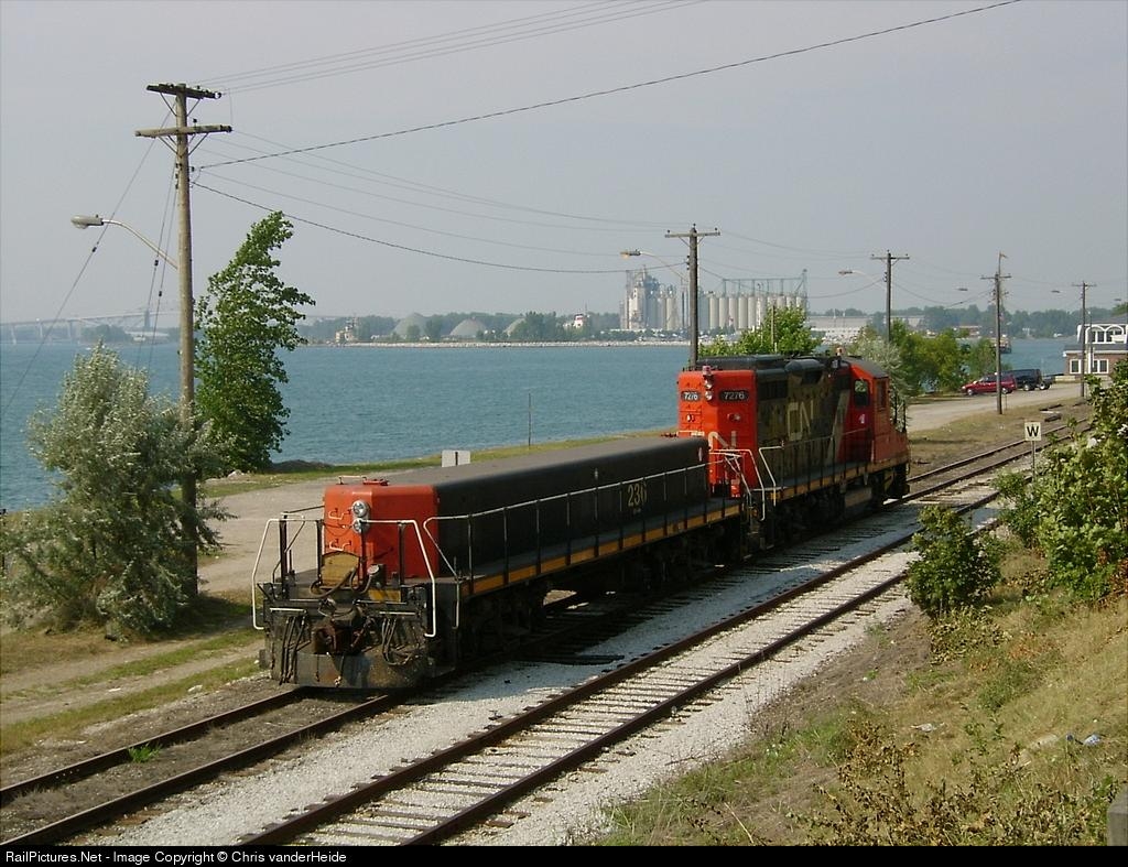

Hello all. I’d like a link, or website with some detailed info. about yard slugs, as I have limited knowledge on them. I’d like to make my own for HO scale for my yards. All I know is they have no engine and no control cab, and get their power from the ‘mother’. Also, they are used in yards at slow speeds. I noticed recently CN has what looks like a GP7 MUed to a slug, working in the local yard. (That was the first time I saw these things for real.) I need a digital camera!!!
All slugs have engines. Their purpose is to add pulling power. Some even have cabs, but not all.
Bob
If a slug had an engine, it wouldn’t be a slug. Slugs do, however, have traction motors (I think that;s what you meant).
The all have electric motors to turn the drivers, but no engine to turn an electric generator. They are pure electric locomotives. Instead of receiving power from a third rail or an overhead wire, the electricity comes from another locomotive having an engine and generator.

CN has a number of rebuilt GP9s (not GP7s) that are set up as slug mothers in the 7200 series. These GP9Rm-Slug sets are pretty common around larger CN yards. My hometown of Sarnia ON has a rather large yard that usually has at least 4-5 of those sets kicking around at any one time.

I’ve seen a couple of those yard slugs working the refinery sidings from the Port Huron side of the river. I’ve watched them from the Vantage Point Marine Center through my field glasses. I always wondered why CN used them in Sarnia, but not in the CN/GTW Tappan yard on our side? Gerry S.
