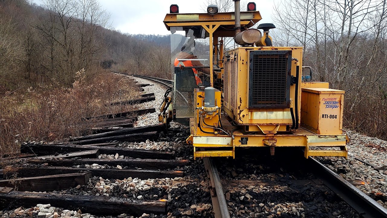

Tie replacement programs rarely replace ALL the ties in a given area. A crew will pass through and mark the worst ones for replacement. Sometime later the replacement gang comes along and changes out those marked.
Might be every fifth tie, maybe more, maybe less depending on budget, projected traffic or age of the majority of ties.
A track diagram will have notations on type of rail, when it was lsat renewed, average age of ties, type of ballast along with usual degree of curvature and grade.
Sure, after a few years they all get aged and ‘blended in’ but for the year or so after a tie gang has been through the new ones will stand out.
