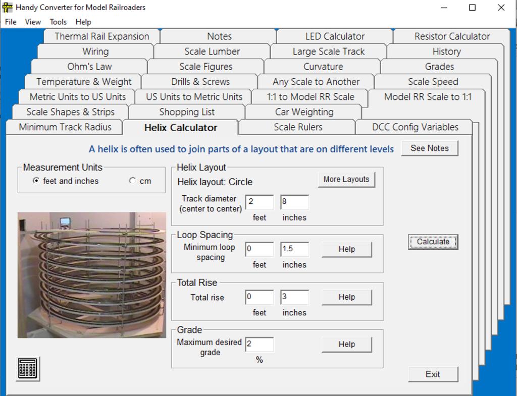

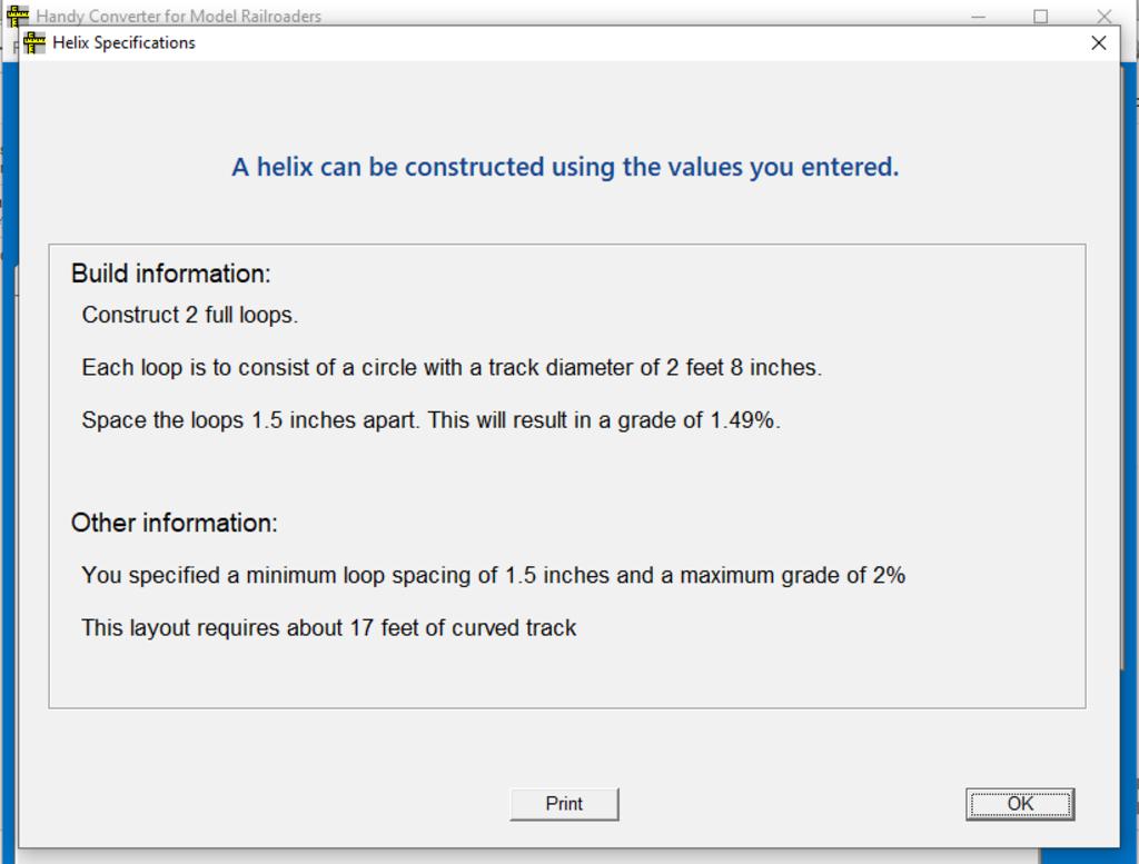

I use the Handy Converter from Stan’s Trains for all my RR formulas, a lot easier than having to use my 83 year old brain.
The converter Z 19° 1’4½” curve is = 3’ 3¾” radius in HO.
Not having any info from the OP I guessed on the input to the Handy Converter.
This is the results from my input. Click to enlarge.
