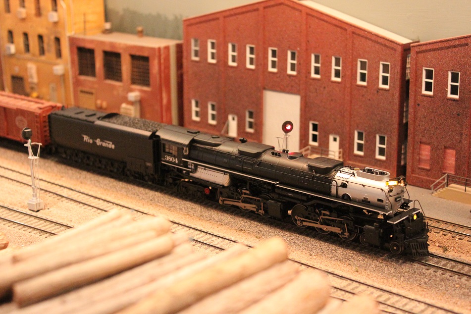

So I dug it out tonight thinking that if I couldn’t get it going I could throw in a Tsunami really quick. On a whim the first thing I did was put it on a DC track. Wanted to see if it still ran at all. It fired right up and I ran it back and forth on the one piece of flex track.&n

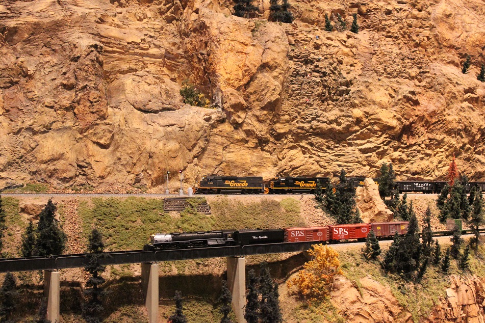

An update. The Zombie performed great! Smooth, quiet, strong. It was assigned to mixed/drag freight #504, and I was able to run it through the layout 4 times. That logs 82 scale miles today. Speed limit is 20 smph. Each time through I added more cars. The last lap it was able to pull 27 NMRA weighted cars up the worst grade ( 2.2% ruling ). That is more than twice what the Sunset Challenger will do. I believe most of that is due to the traction tires. I’m guessing it would be able to pull at least 8 more.
