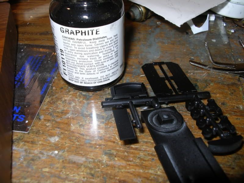

looks like most are w/ engin black or graphite???

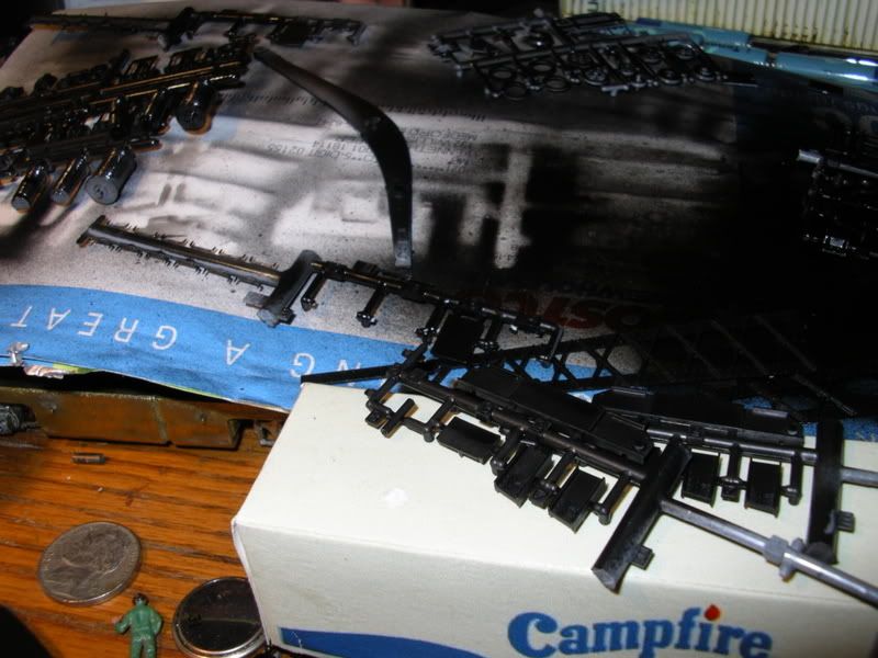

just started to paint mine

well I just add as I go

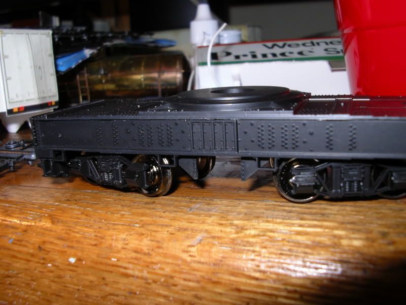

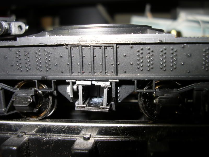

K

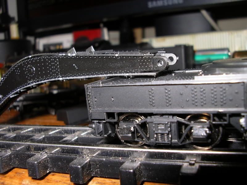

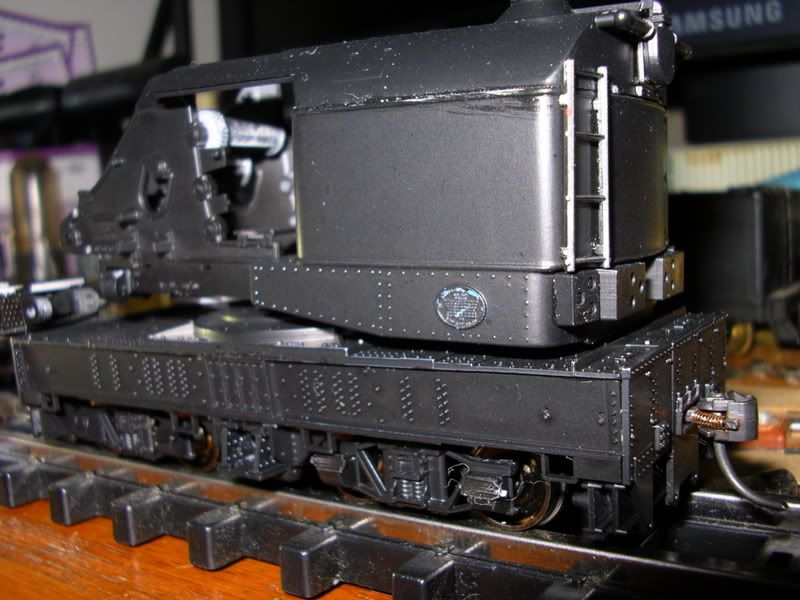

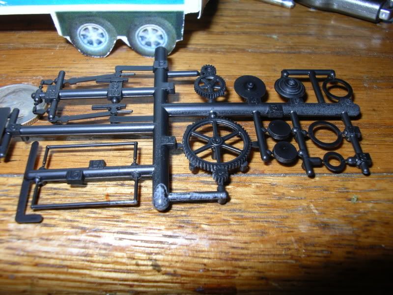

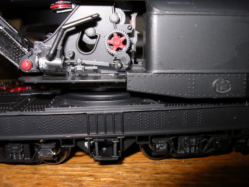

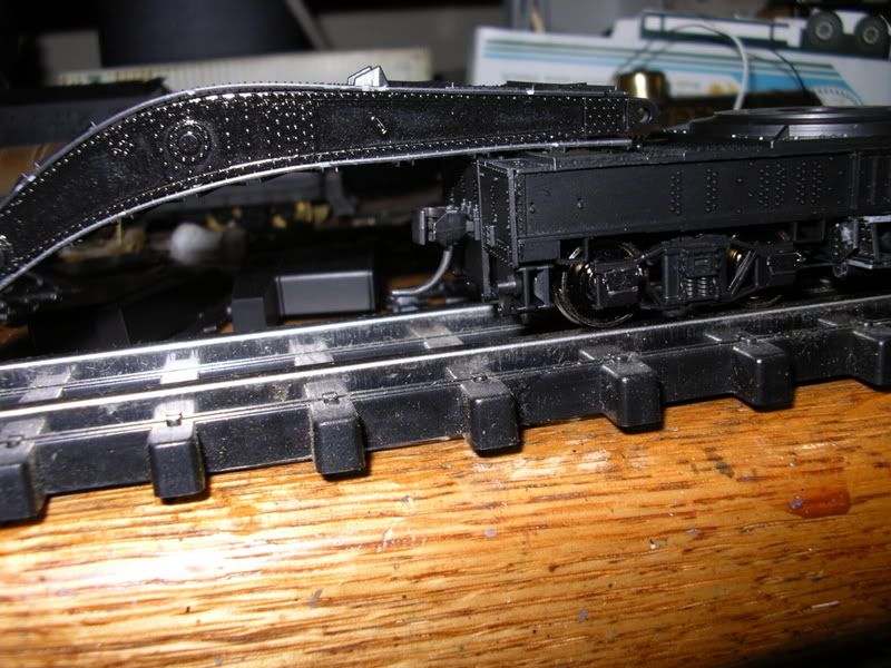

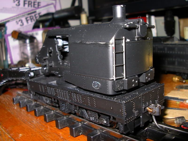

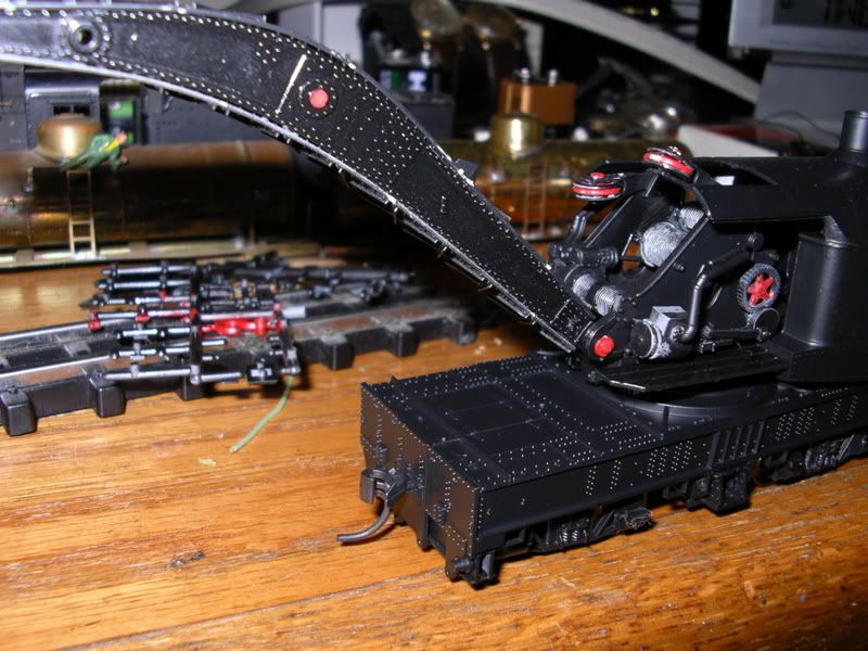

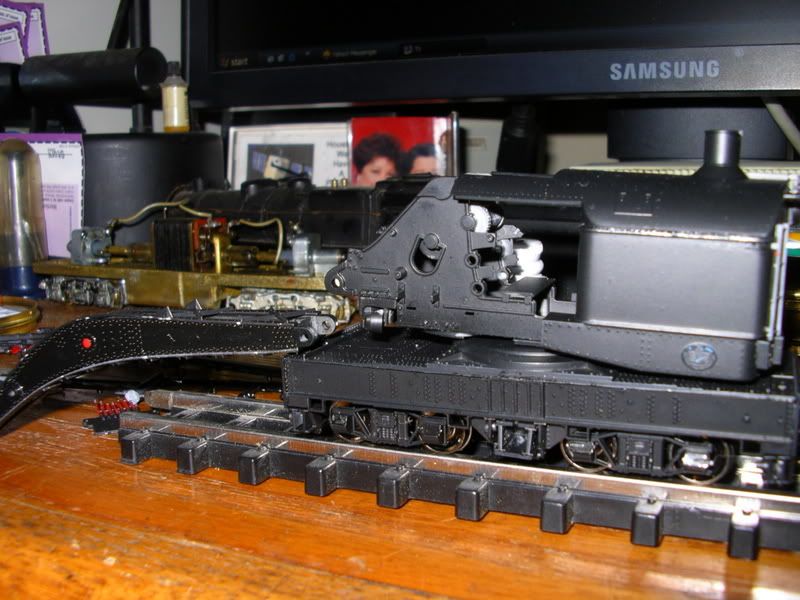

doc I hope you dont mind I add my shots here

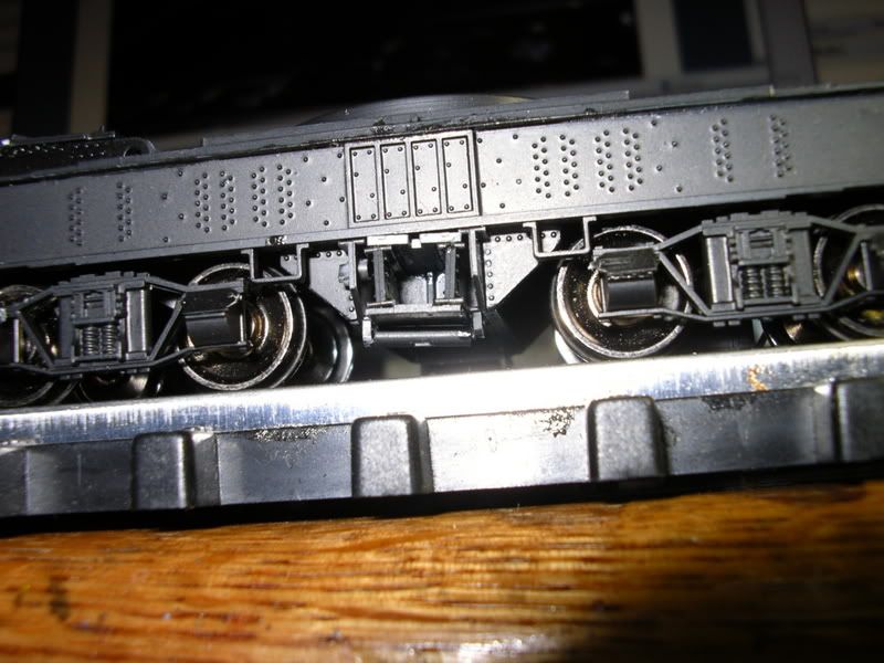

its slow work for me but I get to say I did it all myself
K
well all done what do you think
Ken
now for that boom car
