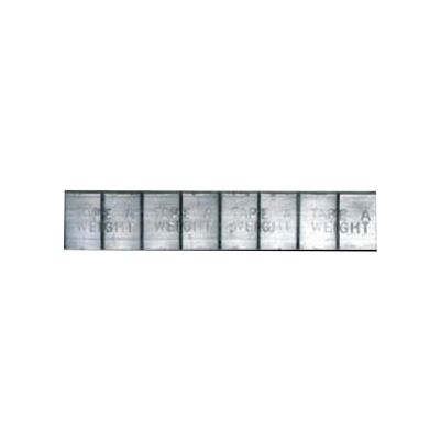

Another method is to use Tape-A-Weight strips. They are stick-on automotive wheel weights that are scored to break up as you desire:
