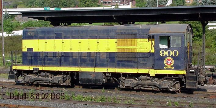

This is the ALCO:

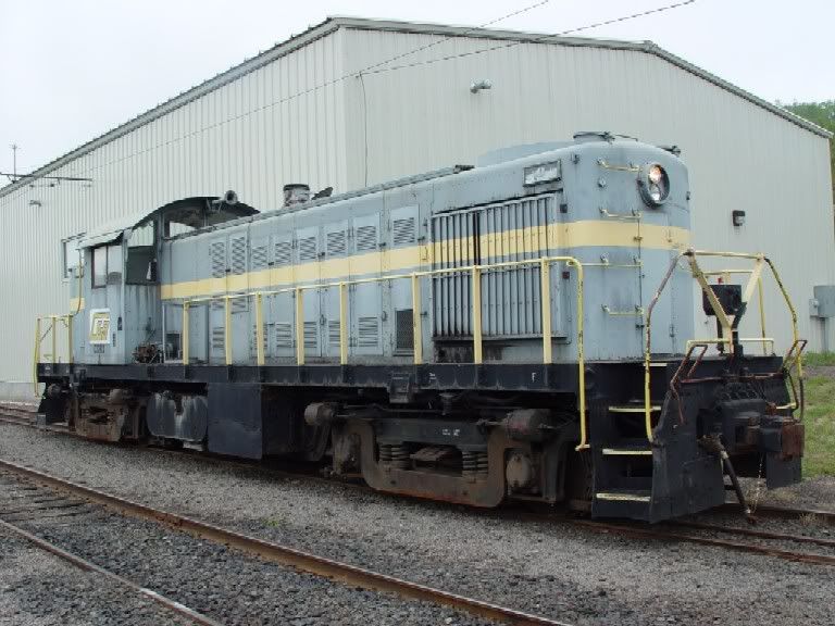

And this is the locomotive you were talking about Randy:
Both pics courtesy of www.tamr.org
Yep, thats it . The roller bearing trucks are courtesy of the ex WC / SOO GP-30s. You need to change that head !
