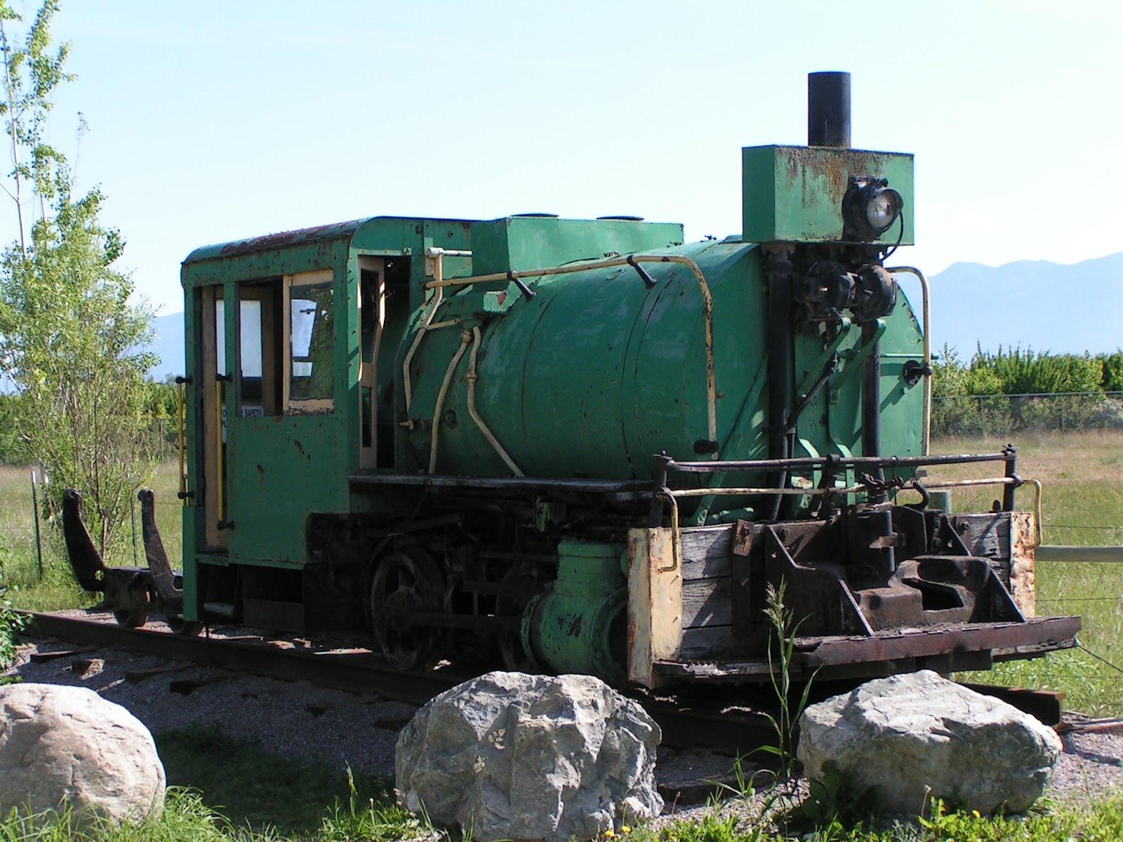

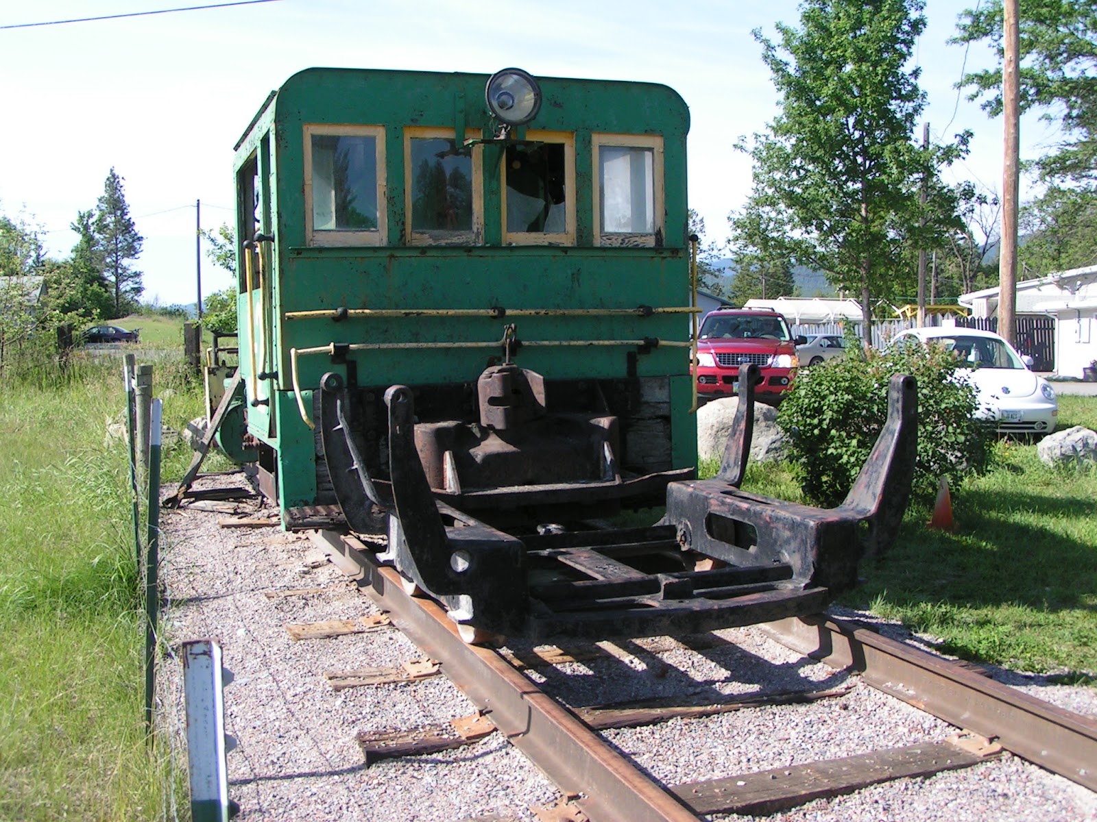

These Porters (S1 & S2) worked the GN tie plant in Somers MT. One is on display in Somers, the other in Polson.
