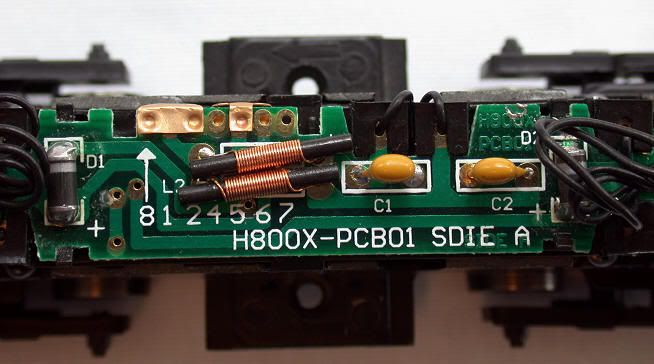

I’m surprised that the motor would still function with one of the leads missing. These leads are attached to the printed circuit board with small black clip on devices. The + and - leads are side by side adjacent to the two capacitors on the board (C1 and C2). The attached photograph shows this printed circuit board. Of course, the lead that you mention may be to one of the two lights and not the motor.

the lead I was refering to was a red pick up lead disconnected at the truck end not the other end Since both trucks are conductive the motor still works. I agree the NWSL fix would be ideal just not worth the cost and hassle for me. This loco only pulls one or two cars when healthy while the 70 ton pulls more cars reliably. and serves my RR well.

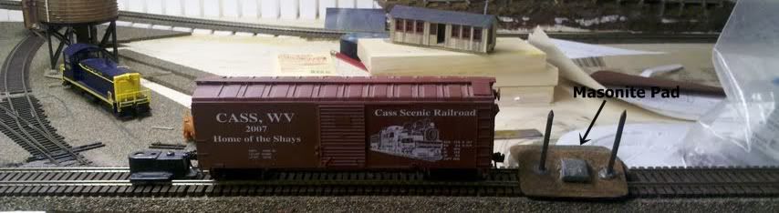

Home made Track Cleaning car sounds interesting care to post a pic?
Give me a second and I’ll take a photo for you. It is really very simple and based upon the design by John Allen used on his Gorre and Daphetid railroad . I visited the Cass Scenic Railroad in Cass, West Virginia and purchased a Cass Box Car that is used for the cleaning car.

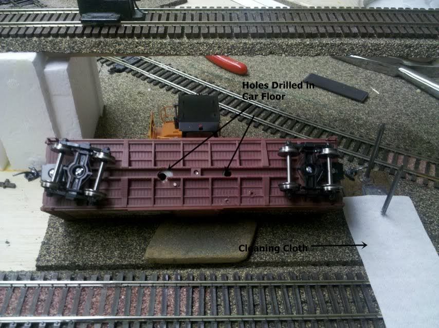

Here are three photos showing my home built track cleaning car. The idea came from John Allen and it does work quite well. Basically, I have a rectangular piece of masonite with 2 nails held in place with epoxy and a lead weight placed between the nails. The nails go into the bottom of a box car and can be run on the track with only using the masonite pad or with a cloth soaked with a cleaning solution such as isopropyl alcohol.
Hope this helps,
