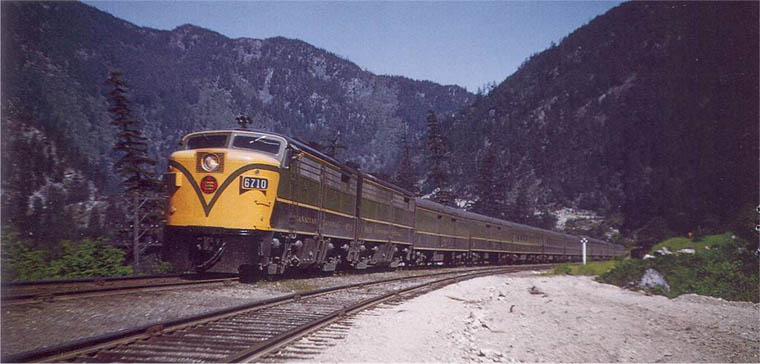

CN repowered four 244 cabs w/ 251 to see if a Psgr version would work = first FPA/B4s, then TRUE Factory FPA/B4s followed in number.
As 244.
http://www.trainweb.org/oldtimetrains/photos/cnr_diesel/6710.jpg
As 251.
https://c2.staticflickr.com/6/5545/11332688733_f64b24abd4_b.jpg

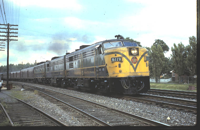

True FPA4 has louvers under shutters.
http://www.trainweb.org/oldtimetrains/photos/cnr_diesel/6779.jpg
The four 4 244 PMs were incorporated into CNR 1800s from MLW. Electrical Cabinet is in SHORT Hood.
