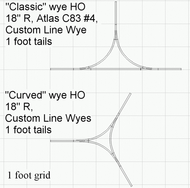

A number 4 wye turnout is half of a straight #8 turnout, so you would need #8 turnouts to complete the wye.
Or you can use 3 number 4 wye turnouts and make an equilateral wye.
If you have access to any of the Atlas track planning books, they usually have different wye configurations in the back.

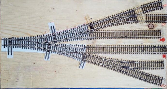

I remembered a photo posted on Trainorders.com in April 2016 (the thread address). Three #3 wyes and two #4 turnouts make a 6-track yard. The poster said “50’s have no problem. I use short shank Kadees and coupled 50’s, 40’ to 50’, 40’-40’ all work fine.” I hope this helps you.
I think that this is what he is trying to do. Maybe yes, maybe no.

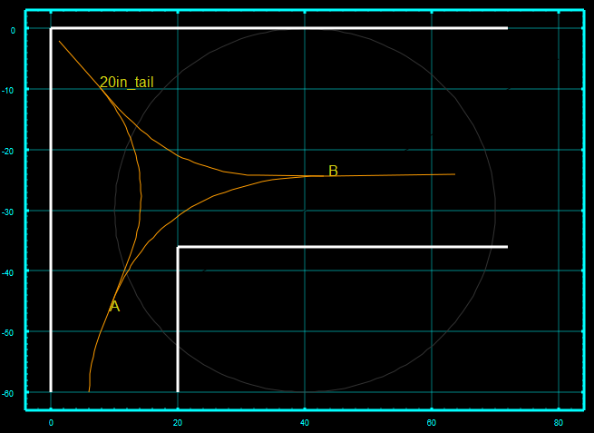

another approach using the corner
#6 swiches, 28" radius curves

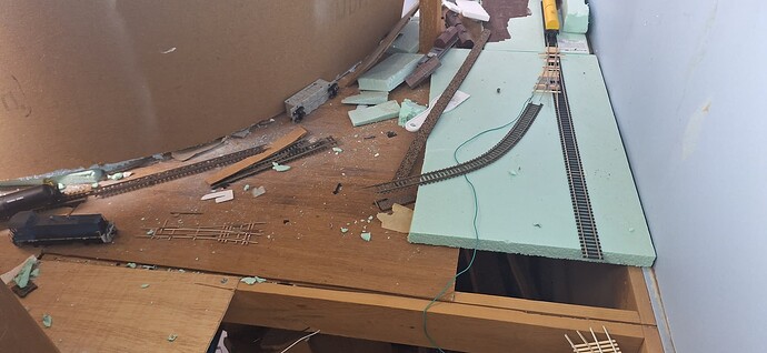

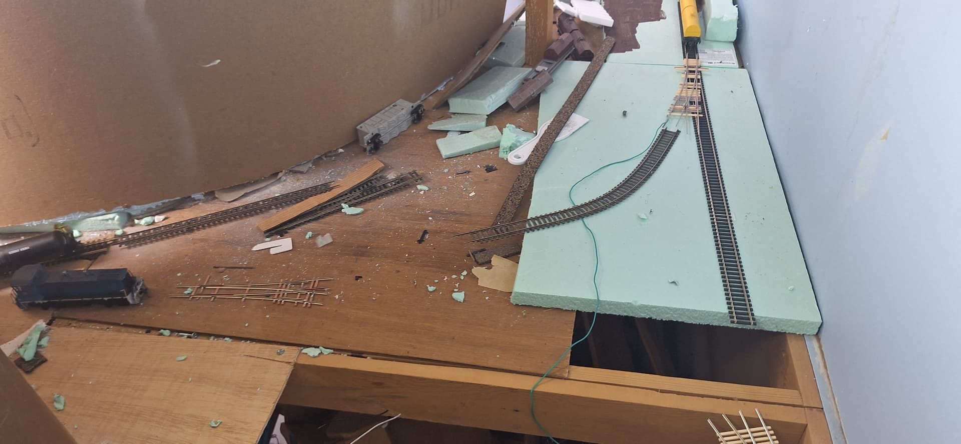

The last few posts have definitely helped me figure out what i need, to build this
Im definitely going to use flex track as well as perhaps build it with 3 Wyes
What im planning. The largest thing to use it will be a GP fpur axle locomotive
The one switch “hanging out” isnt in a permanent spot yet
