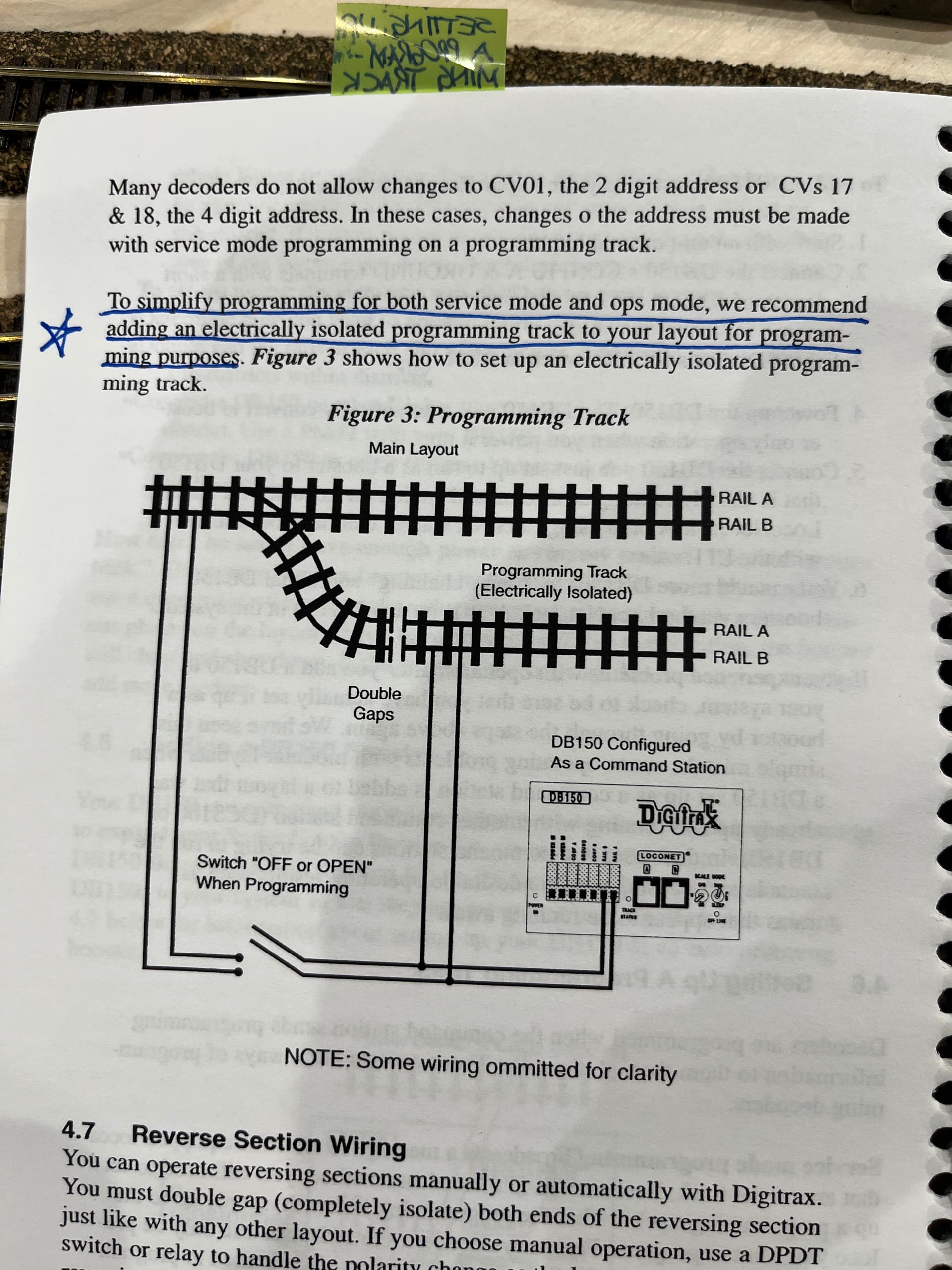

Peter, my command station, a Digitrax DB150, does not have separate outputs for a programming track. The programming track is wired per the diagram in the manual (see attached photo). It has not caused issues previously. The programming track is a completely separate track from the rest of the layout.

That DB150 programming track setup seems rather risky:
  • If you forget to open the ‘switch’ and you program a loco address then ALL your locos on the layout track are going to get that address.
  • It’s pumping the full DCC 15? volts onto the programming track will can/will fry a decoder if something isn’t wired properly.

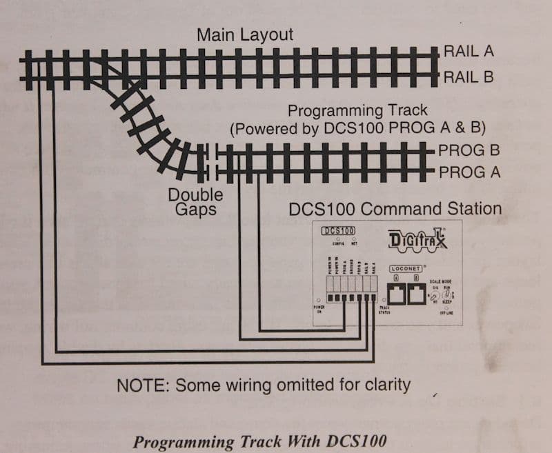

I have a DCS-100 command station you can have to use with (or without) your DB150 if you are interested. I have subsequently upgraded my layout controller to a DCS240+ so the DCS100 is just gathering dust. The DCS100 has a true programming track setup (and can be hooked to computer to use JMRI for decoder programming which is 100X better than using a throttle to program decoders).
Let me know if you are interested in the DCS100.

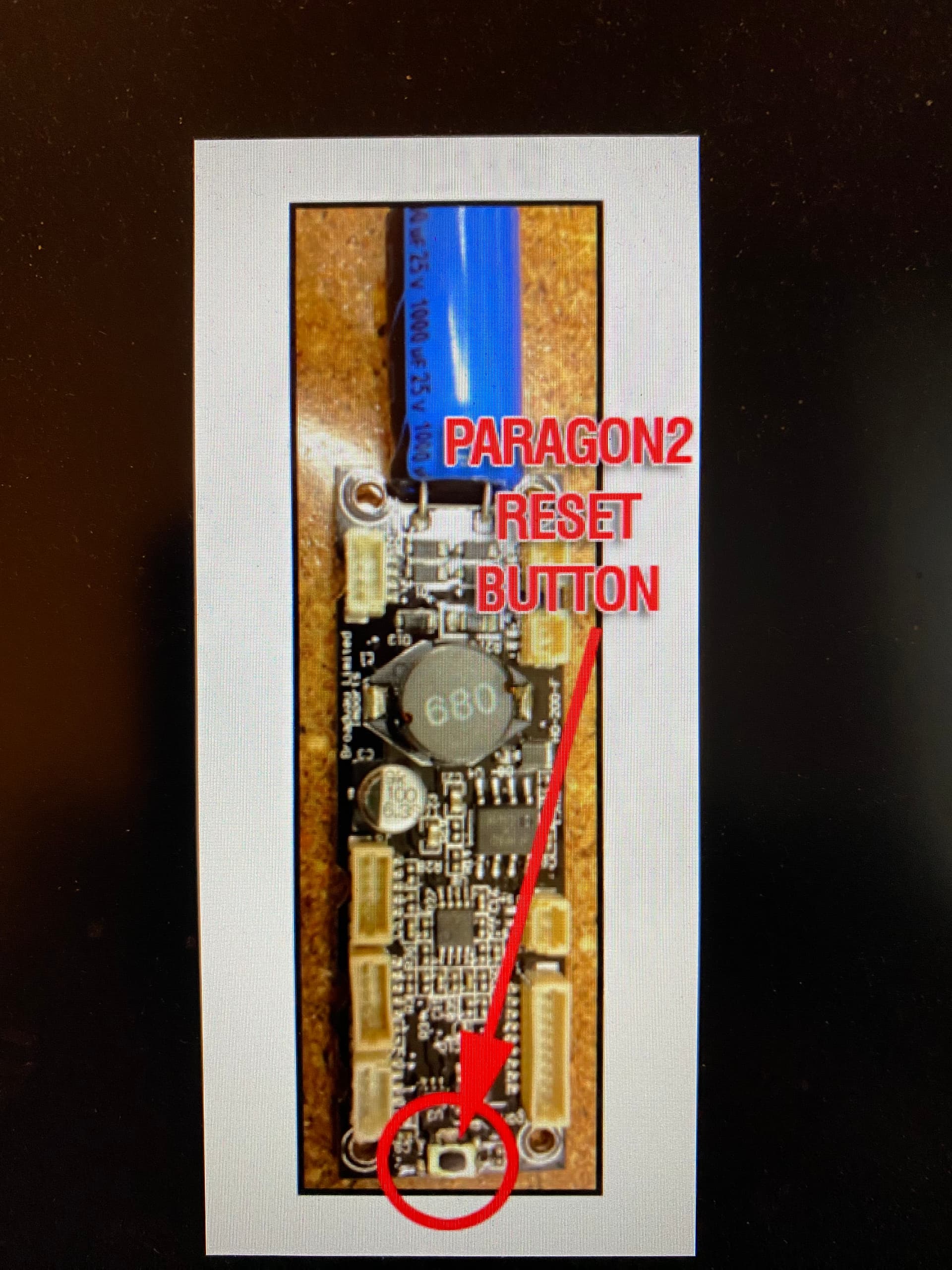

Would you be willing to remove the shell and check for a reset button on the end of the decoder?
wjstix mentions that later versions of BLI engines may not have a manual reset button, but the BLI FAQ section says that Paragon 2, 3 and 4 decoders do have a reset button.
Here is a photo from the FAQ page.
The photo shows”Paragon 2”, but BLI says that Paragon 3 and Paragon 4 have the same reset button.
Regarding Figure 3: Programming Track, just to confirm:
You do have the Programming Track double gapped to isolate it from the mainline?
What type of switch are you using to toggle between the main layout and the Programming Track?

That’s why I am encouraging him to check for a manual reset button on the decoder.
If, in fact, there is a manual reset button on the decoder, which BLI says that there is, I wonder if a wire or some other obstruction is holding down the button.
