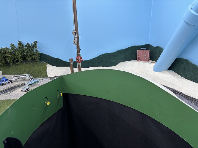

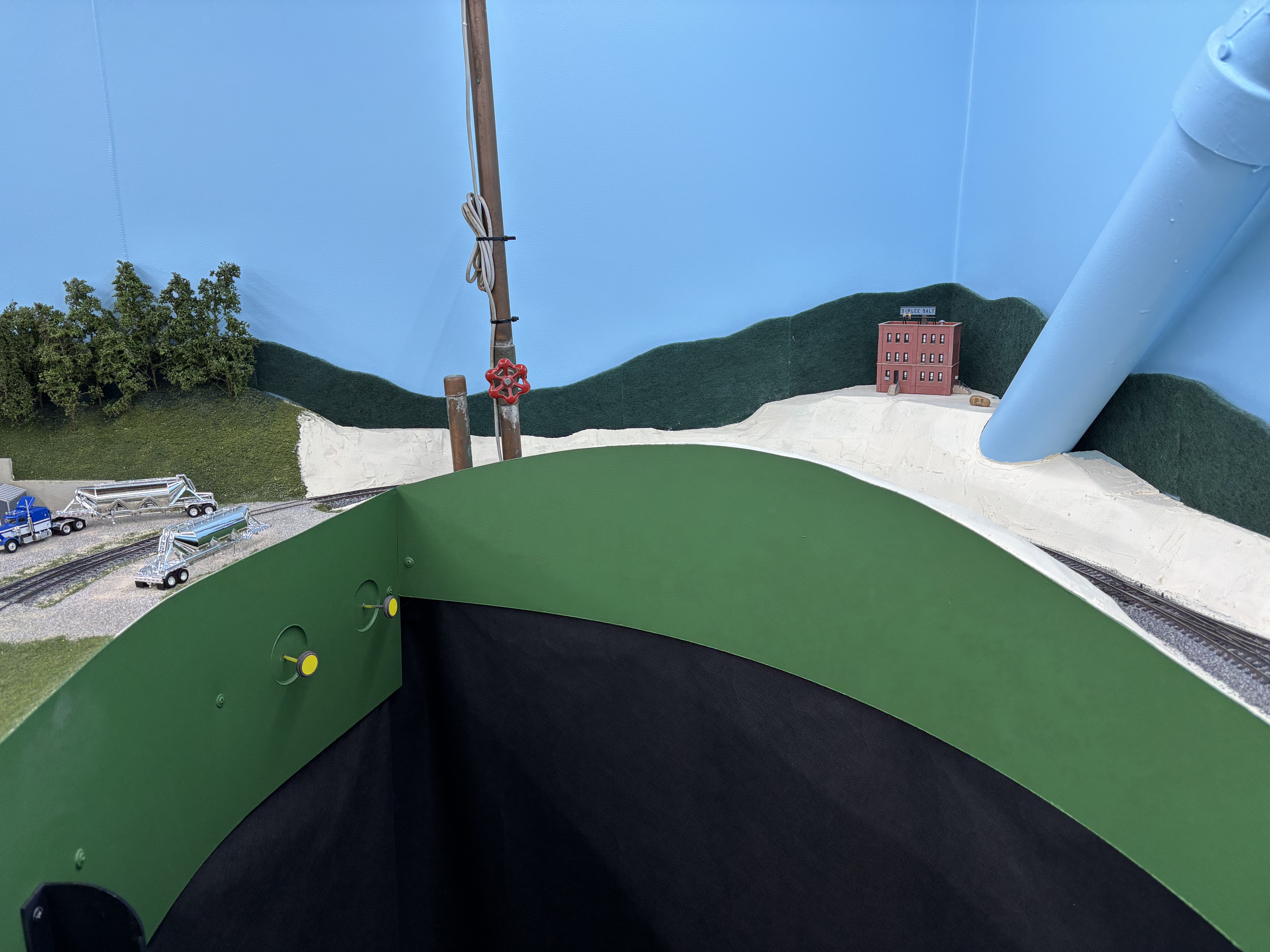

What I use, the idea of which I would swear came from that video, are green 6” x 9” ScotchBrite pads, which you can see that I installed here to hide the blue backdrop from being visible through a few rows of model trees.
Please disregard the water main and sewer pipe that I navigated around to add a staging yard. :wink:

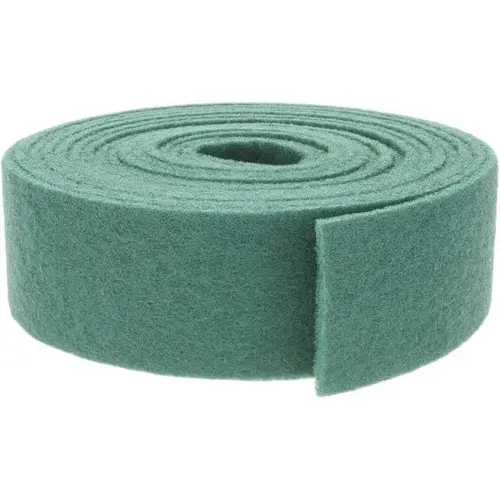

Any number of vendors sell Scotch-Brite by the roll. And a quick search found this:
Why yes, yes they do.
