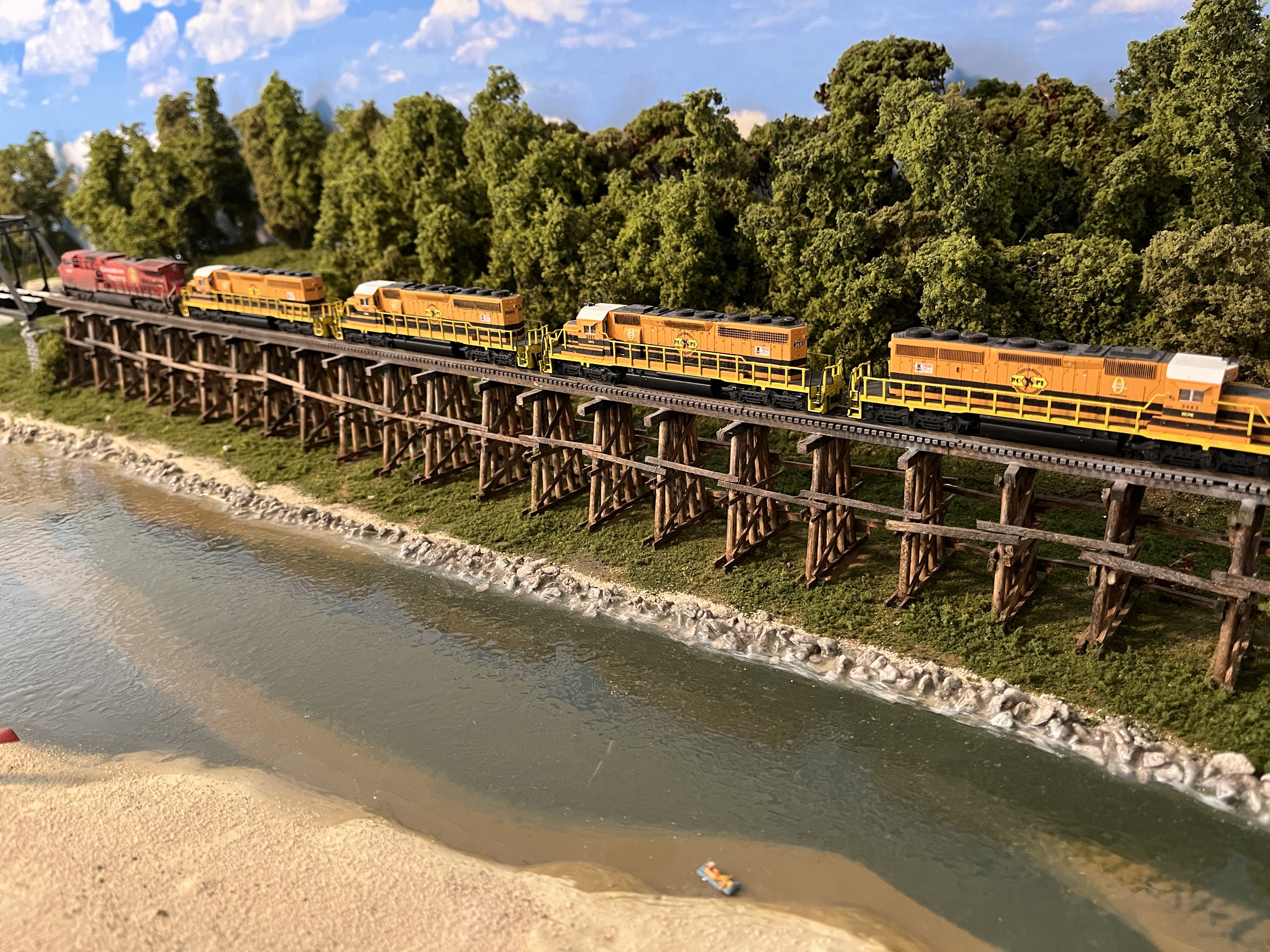

Man, that’s one of the best, most realistic rivers I’ve seen!
