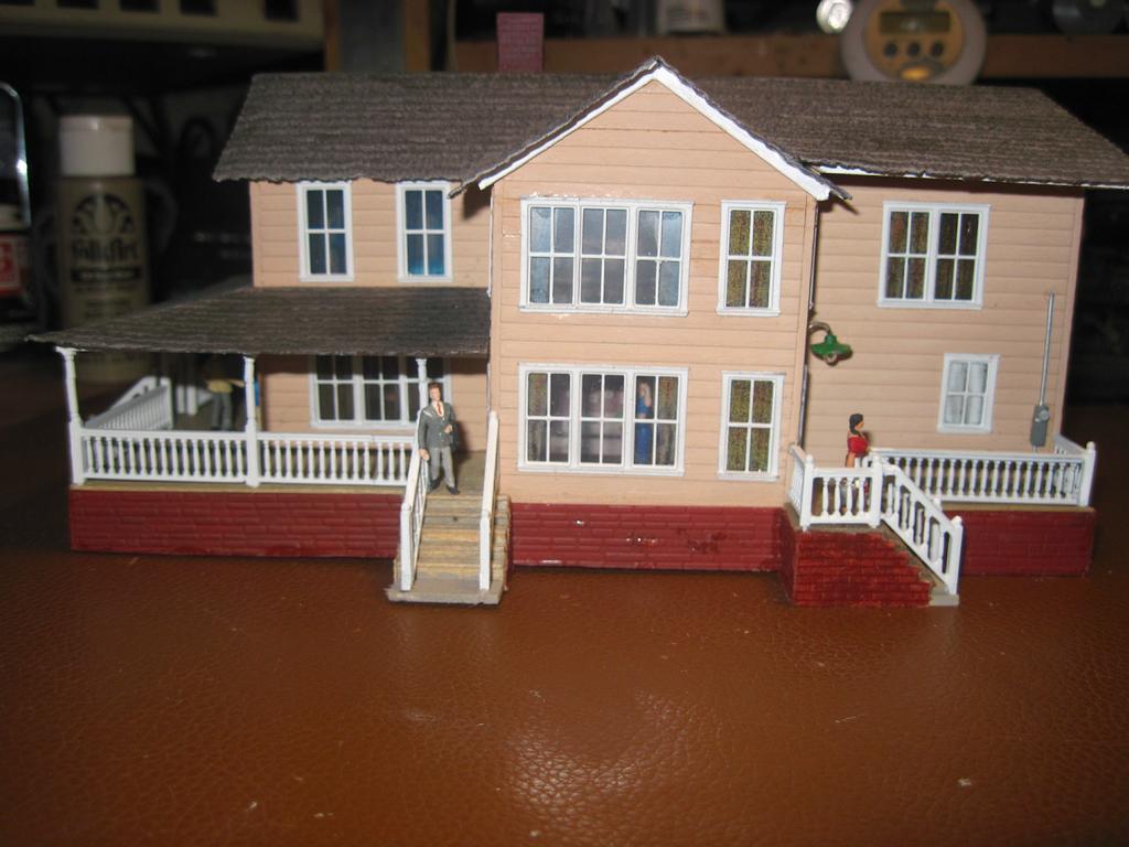

I added a 1.7mm incandescent/lamp shade porch light to a company house similar to the one in MB’s photo above. I centered mine over the door rather than the porch though. Either way - simple but effective.
All of my houses have porch lights, I use 2mm 12 volt GOW bulbs running at 70% voltage for long life and realism.
This house has three porches and a varanda, all have lights.
Even the garages have porch lights.

How about this for a home brew.
The roof is removable and I didn’t want to use a connector between the roof and walls. It was too flimsily using only the bulb wires for support so I slopped some 527 glue on the wires for support. It can’t be seen under the eves.
The upper balcony or veranda light under the roof.
Mel
Looks good Mel…It does sorta look like someone had a runny nose though!..LOL
