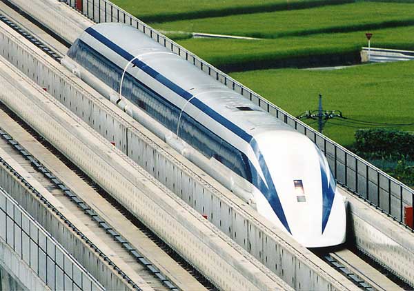

This is a pic of the test train for the superconducting maglev, for those that want to view the aerodynamics of the vehicle, as well as the possible look of the passenger version.
(BTW, I don’t recall hearing about the TGV test train being too loud when it ran at 357.2 mph. This superconducting maglev has been operated at 361 mph in tests.)

The prototype test unit IS a 350mph snow plow. It has snowed on the test track. One pass of the test train and the track was clean.

Look at the shape of that front end. The splat would probably be the critter hitting the ground some distance from the guideway - after the train had passed.
