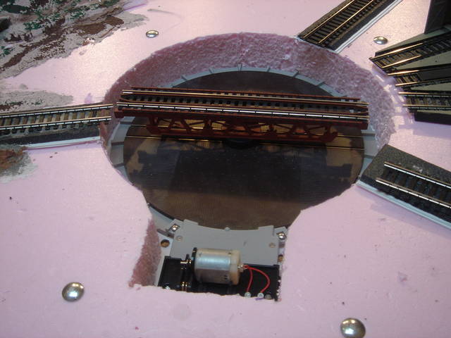

Pit-Bash in process. This is an Atlas deck turntable. I wanted a “True Pit” turntable, but I don’t have room for a “real” one.
I sunk the whole mechanism down 2 inches, and took an Atlas deck bridge. I cut it horizontally and glued it back together to make it less tall. Here, it’s placed on a hub on the deck.
I didn’t want the turntable pit floor to rotate, so I put the hub on another pedestal of styrene, and built a false floor. The false floor is attached to the gray outer ring of the turntable, and doesn’t rotate, although the deck below, with the bridge attached, all turns together. This is what it looks like now. My plans are to install the pit wall over the next week or so.

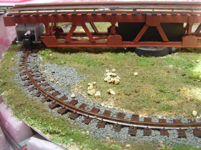

This is based on the turntable that used to be at Avery ID.
its now serving as a mountain branchline turn around for helper service locos.
