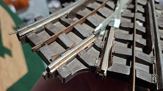

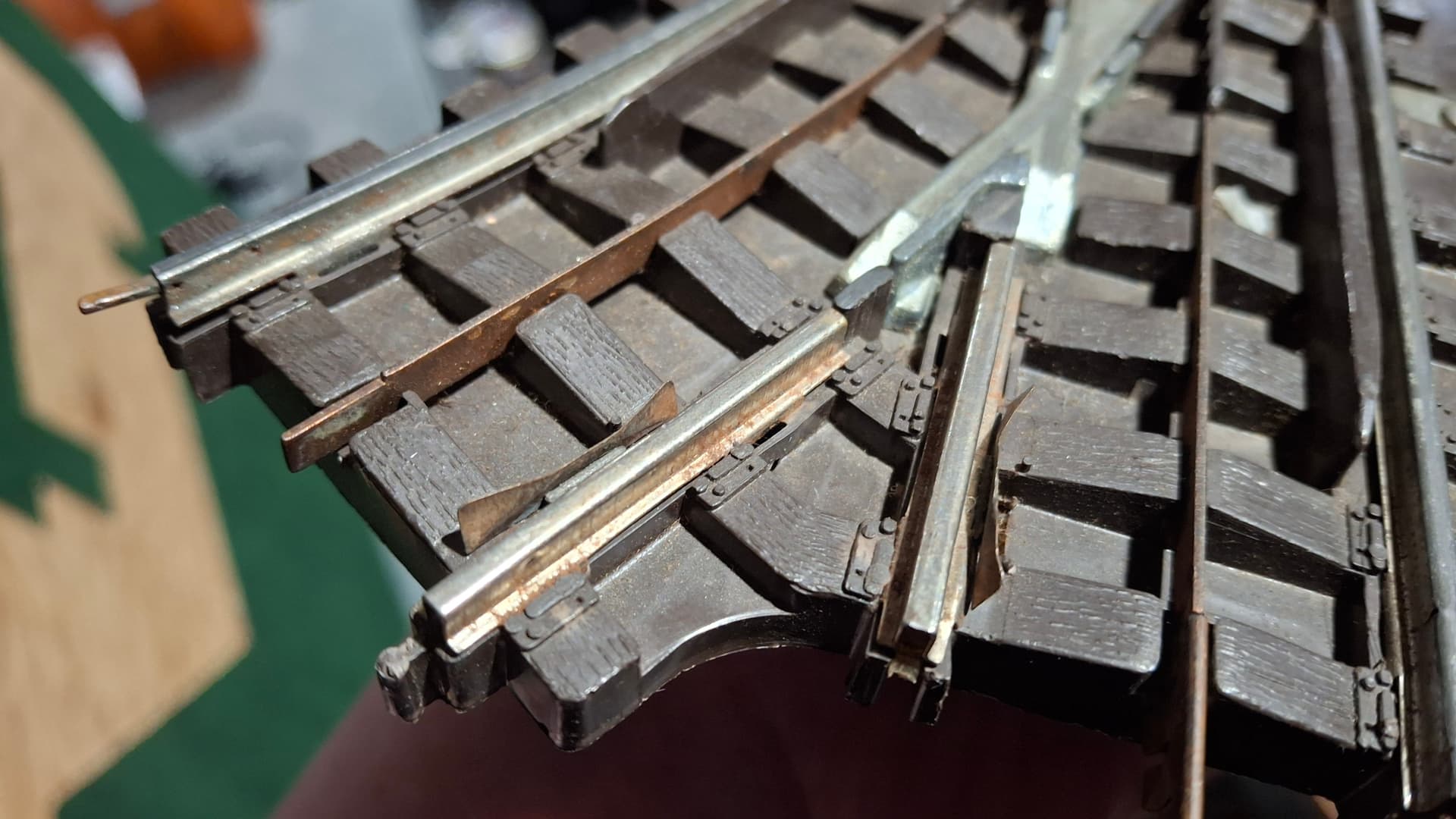

Any advice is appreciated! I have three Super O 112 R switches I can’t get to work. One had a bad ground post so I replaced the rivet with a small bolt and nut. I now get voltage between the bolt and the rail but switch still doesn’t operate.
The other two chatter so I think I have a short somewhere but not sure where to start.
Thanks!

I posted this in the other topic, copying it here for visibility’s sake.
Can confirm this happens. Those little brass tabs sometimes touch the activating rails, and both derailing features are trying to work at the same time. That’s when you get that 60 cycle per second chatter. Quickly followed by burning up the switch motor.:frowning:
