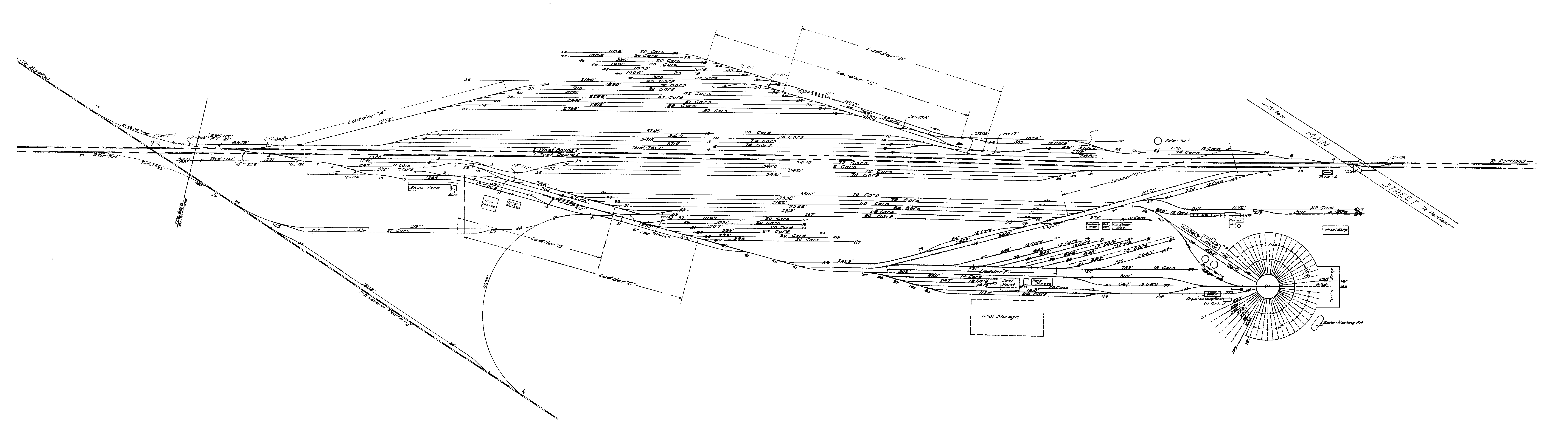

http://www.upward-concepts.com/rail/rigbyl.gif
Rigby Yard, South Portland, Me. South end of yard near wye is an Ice House.

This is very possible. I am still figuring out the traffic patterns, but I have an circa 1951/52 industry list that lists Swift and a couple other meat packing houses as rail served customers. Dont know if they were the actual slaughterhouses or distribution to local stores. Notice also there is a stock yard adjacent to the ice house, again, not sure why they put it there.
The Ice House/stock yard track has a direct connection via 1 yard ladder and one crossover to the outbound main line (from Boston) on the Western Route. The crossovers appear to be set up so that a train can also come off the Eastern and run right to the ice house/stock yard track.
Not sure why both were on the same track? But it seems to indicate the traffic pattern.
Note that the “Eastern” and “Western” route names do not actually indicate their order of appearance. The name Eastern came from the name of the original owner, the Eastern Railroad. The Western route was the original Boston and Maine Route into Portland. When the B&M gained control of the Eastern, they started calling it the eastern division, then Eastern route of the Portland Division.
The Eastern was abandoned in sections, starting with the bridge across the Fore River into Portland Proper (1920s), then in larger sections starting in 1944. Only the section from PT tower 1 to the Fore River remains today (plus a small section in Saco, Me).
Anyway, both lines go to Boston (and other points West and South).
I seem to have gotten off topic.
Off the the Outbound main you take switch 3, 7 and 9 to track 19 (Ice/Stock Yard). Then down 19 to 71/69 run ar

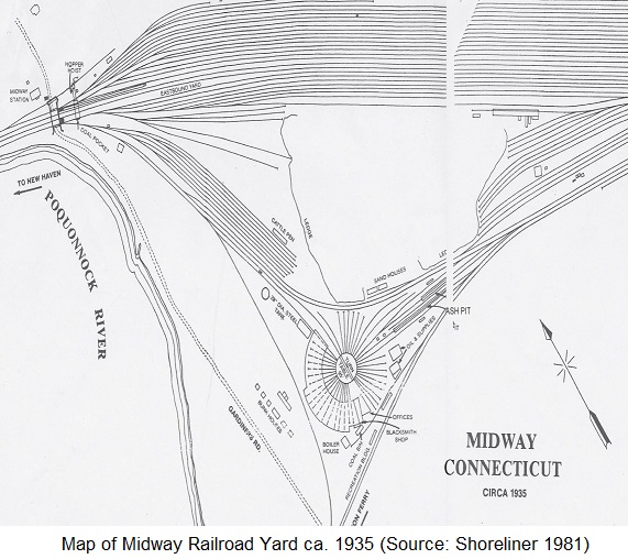

Midway Yard, Groton, CT The building to the right of the paper fold near the top of the map.
http://www.fosa-ct.org/Reprints/Fall2015_MidwayRoundhouse_2_Pict.jpg
