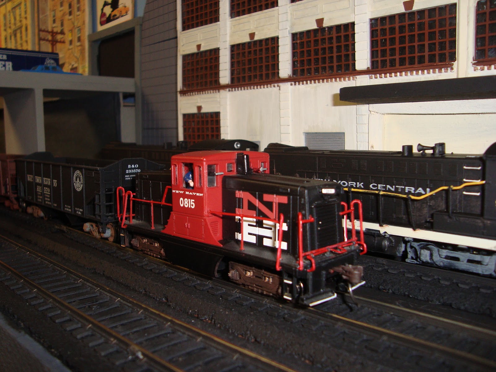

Congratulations on your new addition. Nice pictures and video. Here are a couple of photos of sister locomotive NH #0815 after undergoing a major overhaul last year. This is also a straight DC locomotive and the two motor version. This is one is about 20 years old.
New Haven #0815 passes some New York Central S-12s as it enters the industrial district
Glad to hear she is still running! Did you paint/weather your trucks?
Thanks, she sat in the box for a few years until I broke down, ordered new axle gears through Bachmann and installed them. As for the trucks I dry brushed them with burnt umber and the springs received a light brushing of a lighter color brown.

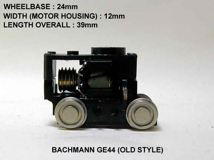

If it is indeed a new loco, it has a single motor inside. Bachmann changed the design long ago.
Below is a picture of the chassis I took as I installed sound, the motor is dead center with the black wire lead leading to it. The 44 ton is a good reliable loco, I have three with many hours on them, I don’t recall having any issues with them besides one truck was out of gauge. These also make a great base for kitbashing, many people (me) use them to replace older unreliable chassis’s with a new up to date chassis with improved mechanisms. I mount MDC Climax and Boxcab shells on them to make great running and low cost, reliable motive power.
No big deal, you have a great switcher. [tup] I believe the older 2 motor version has issues which caused a redesign, but I am not certain. I found a picture of the old powered truck design, these would have been great for kitbashing.
