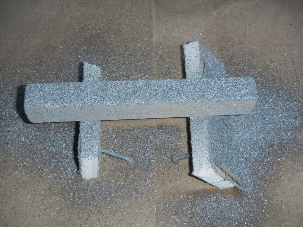

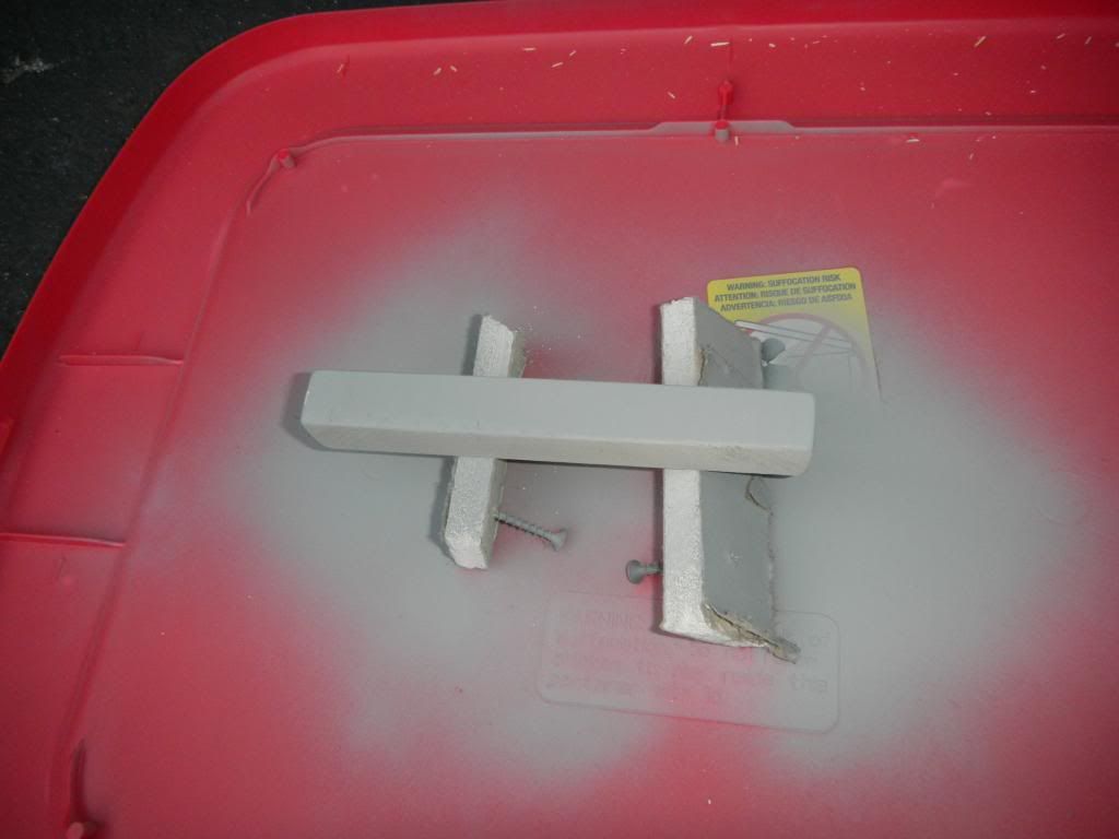

I’ve already got a piece which I painted with the gray primer. Unfortunately was very busy over the weekend with Corey’s B-Day, but will try to put a coat of the gray granite on it tonight and see how it looks.
A couple of quick pics.
Here’s the primer:
Here’s the granite color:

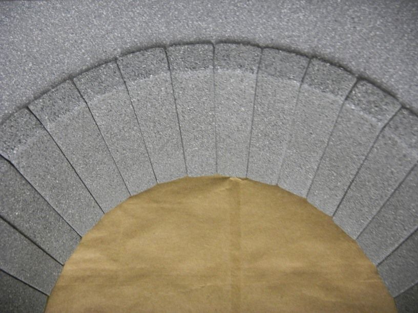

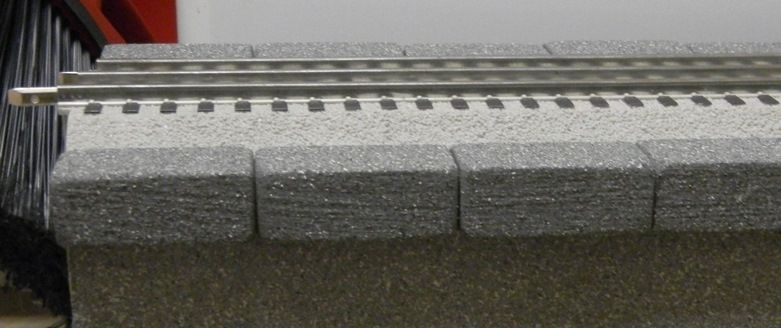

Quick shot from last night - trying to get some contrast between the arch stones and the wall:
Wow, very,very nice.
Looks nice, to give it some contrast you can give it a black ink wash that has been diluted with alcohol. Keep us posted on the build.

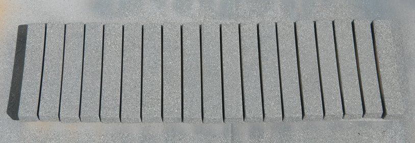

Got a bunch done today - will post more tomorrow, trying to get Tyler and Corey into bed. Linda’s passed out already. Anyway, quick picture of the 2nd set of under arch stones with their paint. Emptied out a Valspar can of primer and switched to a Rustoleum primer - the Rustoleum goes on darker and seems to have a slicker surface - very surprising for a primer. Here’s the shot:
