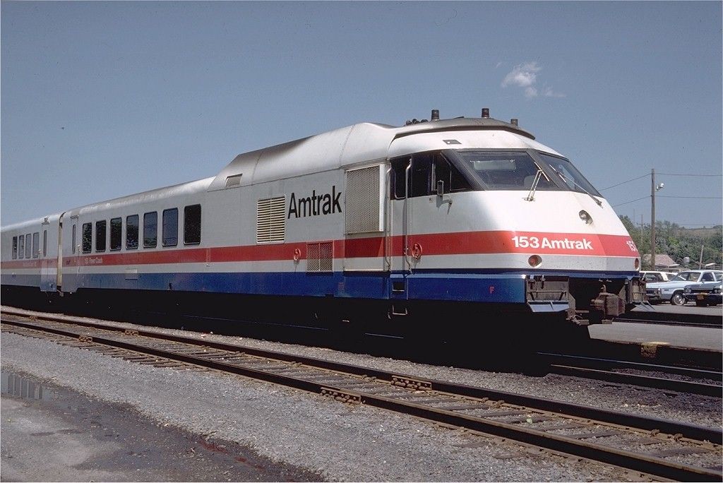

Turbo trains made sense when fuel prices were low. They are extremely inefficient when the turbine does not run at ideal speed. Huge increases in fuel prices plus unusual maintenance requirements are why Amtrak would not use them.
I rode them quite a bit. Amtrak got them in the late 70s - about the time NY State was paying Conrail to raise speed on the Hudson Line north of Poughkeepsie.
They were smooth and fast. They were an off-the-shelf design modified with a nose/cab and had the car bodies bumped out to 10’ wide between the vestibules.
The combo of better track, higher speeds and these trainsets increased ridership on the Hudson line to a large degree, so much so, that NY has had to build two iterations of stations in Rensselaer to handle the crowds. This was the one corridor outside the NEC that actually got the speeds, equipment and frequency to succeed. Too bad this success wasn’t emulated elsewhere.
My recollection is that they burned regular #1 diesel or jet fuel. The rap on gas turbines was always high part throttle and idle fuel consumption. At full throttle, gas turbines are plenty efficient. The trick was to keep them busy or plugged into standby between runs. I don’t think the overall fuel economy of these trains was all that bad, if I recall some of Jerry Pier’s earlier posts.
I don’t recall them being out of service for any period of time due to fires. In fact, they ran for 25 years or so before the ill-fated rebuild program.

1.0 The “know-it-all” aerospace company (Rohr Industries) had a a rail division in which I was Program and Engineering manager forthe 6 train Amtrak project. My team of 250 engineers included many with railroad expereince (I cam from WABCO) and the manufacturing team had built cars for Bart and WDC. We built the seven trains on schedule and for the contract price.
2.0 There was no tendency for the Turbmeca Gas Turbines to catch on fire. The only fire I’m aware of took place on an RTG power car as a result of failure to conect a ground cabble while the unit was in contact with the 3rd rail while parked in Penn Station.
3.0 The gas turbines did not require any special attention while in service, in fact they required less maintenance than an equivalent diesel. The attendants that rode the trains during the early days were primarlly to monitor and give Amtrak a “warm” feeling. It was a nice job. The Turmo III gas tubine had been in service on the French RTG’s for a number of years (SNCF operated 35 RTG Trains with this gas turbine and it’s successors for amny years) We looked at the 1500 hp tank turbine but it had no experince at the time (1973) and was not comercially available. Amtrak insisted on the Turmo III or equivalent and there was no equivalent.

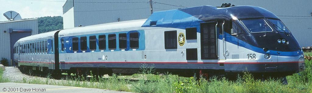

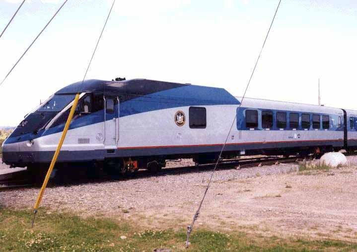

The RTL Turbolners were very popular with Amtrak’s customers as well as with the maintenance staff at Renssaelaer. In 1994, after 17 years of continuous service, the train interiors were a little worn and Amtrak decided to do a limited refurbishment including re-engining with 1600 hp Turmo 12 engines and electronic turbine control replacing the original relay type. This was done at a reasonable cost and with good results. The train, designated the RTL II , performed very well and got a favorable response rrom the passengers.
In the mid 1990’s New York State took title to the trains for the purpose of parforming a complete

right out of the box:

The ROHR Turboliners were built to US, not French standards. IE: Buff strength, center couplings, Air brakes and 60 hz power. As I recall, this added about 300,000 lbs to their weight. The body shells were built,and painted in France to our specs, shipped on deck to LA and then trucked to Chula Vista. As noted in my previous sumission, key engineering people had railway experience. The turbine controls, heating, lighting and aircondioning controls were designed by Rohr and built or purchased to our specifications. The trucks were completely of ANF design and manufacture.(These are far superior to any US truck at speeds up to 125 mph) Once the engineering was complete, we built 7 five car trains in 6 months and delivered them to Amtrak in Chicago under their on power. In the whole process I worked closely with the French Company and gained a high llevel of respect for their engineering and construction capabilities.
At the conclusion of the project, the ANF Chief Engineer told me they were very impressed with what we had accomplished in such a short time and admitted that out finished train was better than their RTG.
