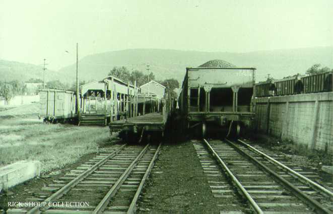

Best I could find on short notice is this picture of a PRR hopper next to an EBT flat car.
http://www.spikesys.com/Bin/EBT/rcs_64.jpg
