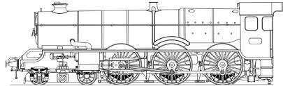

Did not know that the Great Western had locomotives with trailing trucks. What was the Kings’ wheel arrangement? 2-4-2? 2-6-2? When built? Swindon? When last used? If they were tank engines, it would be strange to be referred to as Kings.
King class is 4-6-0. Since there is only one truck, ‘rear truck axle’ is the back axle in the truck, the one that has to clear the crosshead and guides, and the forward truck axle the one ahead of the cylinders.
Note that I purposefully avoided using the words ‘trailing’ or ‘leading’ axle in referring to these two axle positions within a rigid-frame (Adams) lead truck.
The Great Western did indeed have a locomotive with a trailing truck – a rather famous one, named for a famous constellation. Can you name it and describe its significance?

It is worth pointing out that while the trailing axle on the King bogie had to clear the outside cylinders, the leading axle had to clear the two inside cylinders, hence the position of the springs. Holcroft, who had left Swindon by that time indicated that the King bogie design was submitted more or less as a joke by a draftsman who couldn’t think of any alternative.
The other four cylinder locomotives (Star and Castle clases) used a bar frame truck with beam equalised axles with a semi elliptic spring located each side between the axles. This provided adequate clearance for both inside and outside cylinders. It isn’t known why Collett wanted independent springing but in the LMS Princess which had exactly the same cylinder layout and sizes as the King, Stanier used the bar frame design. Since the Princess was heavier, that can’t have been a problem.
The original truck design on the King had some problems with detail design of the suspension, and modified springs were fitted to King George V while in the USA for the “Fair of the Iron Horse” in 1927.
