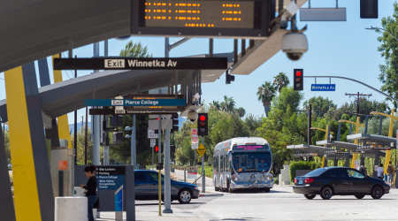

Orange Line buses often get stuck at red lights, slowing transit times. Photo – Steve Hymon/Metro
The Los Angeles County Metropolitan Transportation Authority’s (Metro) board has approved a staff recommendation to study proposed safety improvements that could lead to converting the Orange bus-rapid-transit (BRT) line

More positive light-rail-like optimizations have long been touted as beneficial for BRT on dedicated busways; the gates in particular may aid in higher practical speed, and it should be only slightly more expensive to ‘bridge’ the two bottleneck crossings with rubber-tire suitable decking than with rail. I note also that the New York bus story mentions specific technology that would help the ‘red light’ problem at the beginning of the story.
