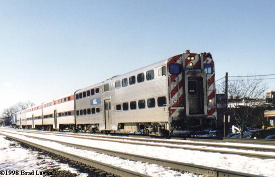

Used primarily in commuter service. Locomotive and x number of cars, last car having a space where the engineer sits with duplicate locomotive controls. In one direction, engineer is in locomotive, pulling per usual. At end of run, instead of turning locomotive or entire train, engineer simply walks to other end of train, gets into cab in cab car and locomotive now pushes the train in the other direction.
If you look at these commuter cars, you’ll notice that the end (cab) car has a headlight, horn, windows for engineer, etc. Since the lights are on, this train is in push mode.
(Forgot to note where I pulled the image from. Oops!)
Mookie: Here’s a simple explanation of push-pull.

A few comments from an engineer that operated cabcar equipped suburban trains for twenty years (and bear in mind that the specs on any new equipment may be different from what I ran on the CNW):
The pilot of a cabcar is designed completely different than that of a locomotive. The photo tree68 posted does not show enough detail, as the pilot is in shadow, but the configuration is such that a vehicle (or whatever) that is struck directly broadside can easily get jammed between the main deck and the pilot. When you hit a vehicle (as I have done many times) the first thing you look for is the struck object off to the side of the tracks. If you see it, you can breathe a little easier while the train is stopping, knowing that you will not derail. One time the vehicle my train struck DID get caught, and it was an anxious few seconds until the train finally stopped (from 70mph).
The pilot itself is much smaller than the pilot (plow) on freight locomotives. It is held in place by support posts from the car body. It is suffiecient to deflect rocks and refrigerators and other objects places on the tracks, but when a vehicle is involved, I would much prefer to have a locomotive-type plow. The problem is that the cabcars must also be designed so they can couple onto other coaches, even from the cab end. So a large, locomotive-style pilot is not really possible.
