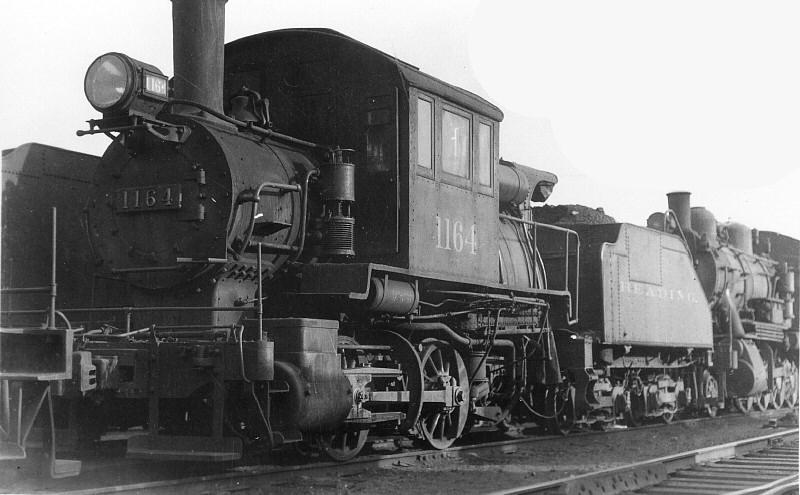

Comparison:
Were there Reading 0-4-0s with slope-backed tenders?
plenty of others at North East Rails - Reading Steam
Did any Reading 0-4-0s get straight-back tenders while still working for the Reading?
Would Age of Steam do a service by changing the tender to a slope-back and relocating the headlight?
Yes RDG switch engines got square tenders and 2-8-0’s in yard service sometimes got large slop back tenders that were also used on 0-8-0’s.
