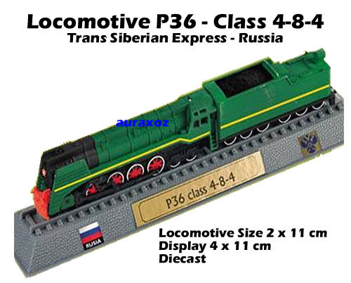

Oh, and in N scale there are/were some display models manufactured under the name of ‘Locomotives of the World’ by the firm ‘Del Prado’. For Russia they produced the SU and P36 classes, seen here in their model form (the pictures are from Ebay listings).
1-160-Silverline-Locomotive-P-36-Class-4-8-4-Diecast-Russian-Russia-New-2013-14
Though static models, they could probably be modified to accept commercially available mechanisms.
Oh, but then I forgot to mention that the Su WAS a prewar class!
