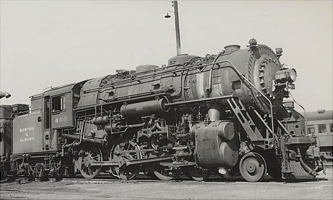

Although there are about a dozen recognized types of tank locomotives, in the United States only three of these were ever common - the two types cited above and the “rear tank” design. This latter class included both some of the smallest and largest examples of all the tank locomotives. Some of these in switcher form, particularly from the mid to latter half of the 19th century, probably had a capacity of no more than a couple of hundred gallons of water. At the other extreme were the hulking Boston and Albany 4-6-6T bi-directional suburban tank locomotives used in passenger service.

The CNJ’s 2-6-2T class J-1 (later SU-23) side tank suburbans, totalling 25 engines and indeed a favorite of mine, began appearing on the property in early 1902 when much of the passenger equipment was still wooden. The introduction of steel coaches for commuter service around WWI was soon taxing these engines capabilities and in 1923 the CNJ began taking delivery of six much heavier class H 4-6-4T suburbans with “rear” tanks. With the passage of time, the 2-6-2T’s grew less and less practical for handling commuter runs and the first went to the scrapper in 1935. By July of 1945, all were were gone.
Of course, by the end of WWII even the larger class H’s were feeling their age and as many of the class J’s had dropped from service standard 4-6-0 camelbacks, equipped with rear-facing tube pilots on their tenders, took their places. Although they tracked less surely than t
