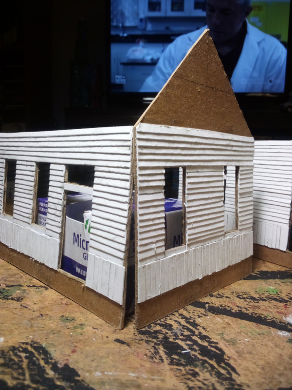

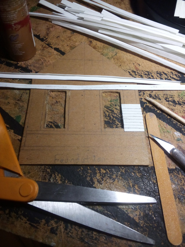

After drafting the main walls on the heavy card, I cut them out and then cut the window and door openings using a cutting wheel in my Dremel.
After taking a break to remove the Christmas tree from my living room, I started experimenting with the one piece of the model I have never done before: creating convincing dimensional siding from strips of cardstock. I went with 2 layers of 65 pound card and the overall effect is pretty good.

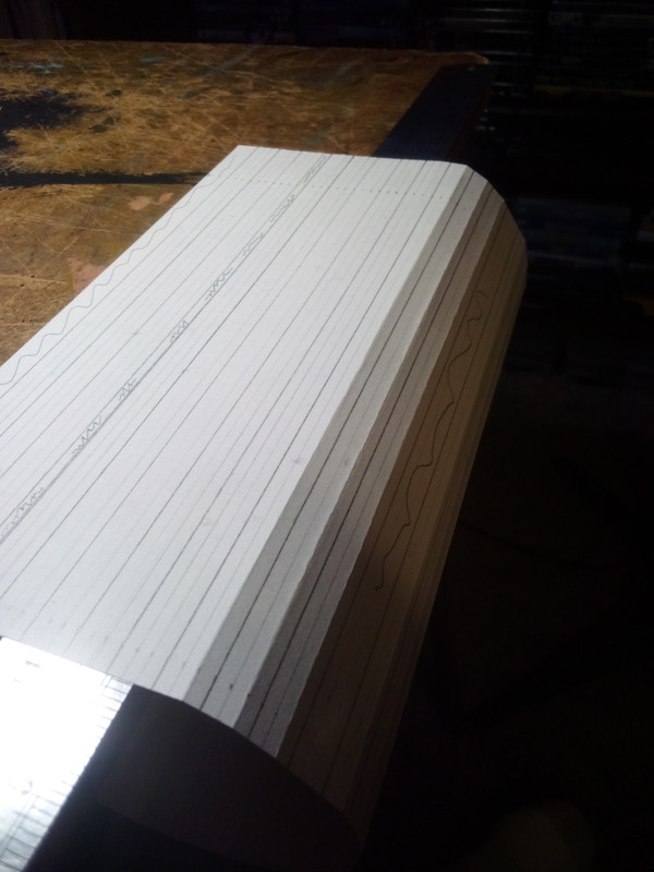

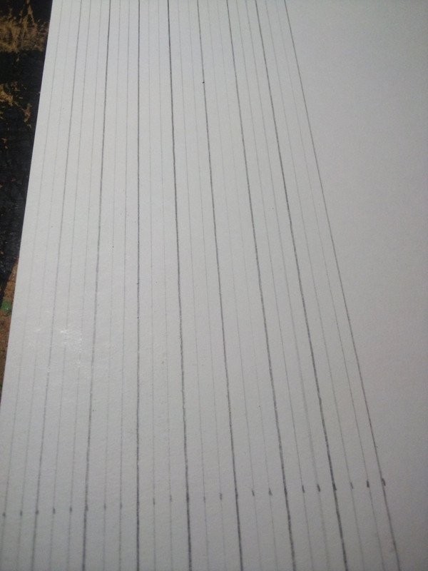

To do this I first measured 3 segments 1/8 of an inch wide and drew the lines. 1 for scoring, the next for placement of the next slat, and the third line for cutting. This allows an overlap from one slat to the next
Oh, this is gonna be gooooood… [:D]
I agree.
Drawing up some siding. Going from left to right, a “board” is a fold under piece to be glued to the back side of the next 1/8" strip. Therefore the third strip just to the left of the darker (cut) lines is the double thick facing of the board.
If that makes sense [;)]
After lightly scoring the fold lines, I used a straight edge as a bending brake and pinched the fold along the metal edge:

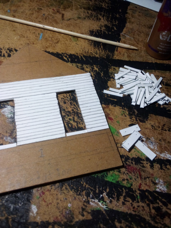

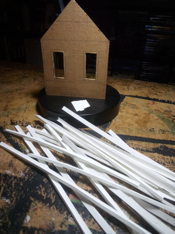

Cut, folded and ready for gluing, the fate of the project comes down to this pile of paper:
Strips are 8 1/2" long so I only get 9 boards for this 3/4" wide wall.

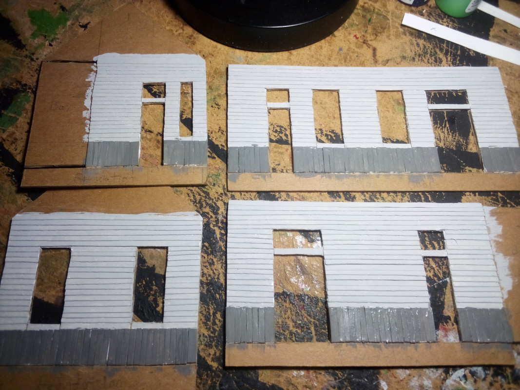

I’m going to go ahead and call that part of the experiment a success. It has the sawtooth profile I want but not high enough to cause a problem with the trim pieces that will go on top of the siding.
On to the wainscoting:
The trim and paint should cover some imperfections [;)]

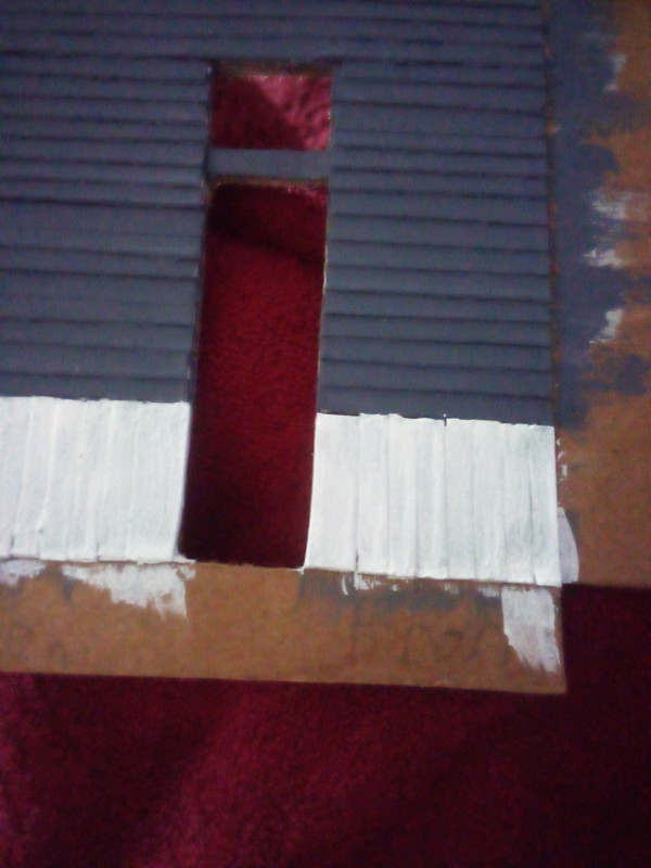

When paper gets this thick it can be sanded, carved otherwise cleaned up using almost the same techniques you would use with balsa.
Of course I don’t actually HAVE to remove my gluey fingerprints from the walls. I could just say it’s a new advanced weathering technique [;)]
The idea of painting a light color under the dark part and a dark shade under the white part was an attempt at creating grain texture and weathering. It worked mildly well under the white wainscoting but on the main part of the walls it didn’t help.

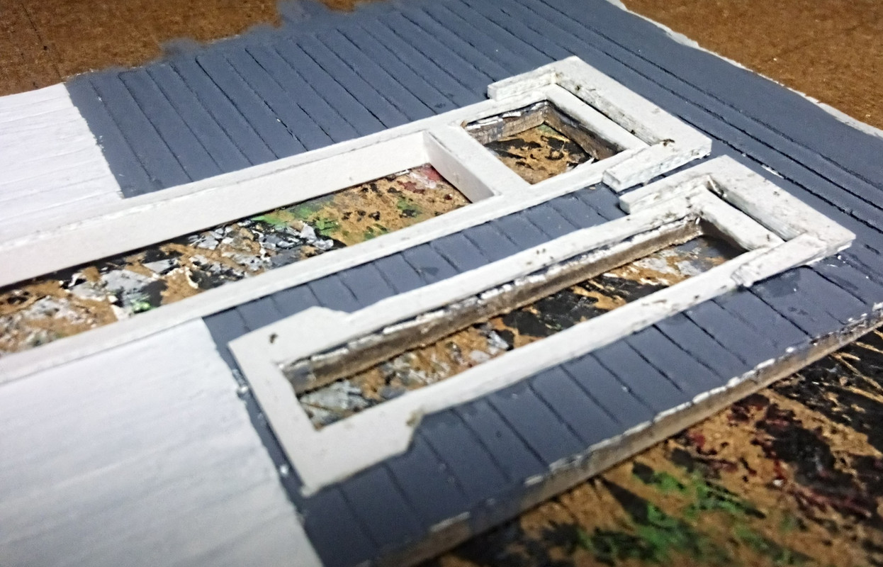

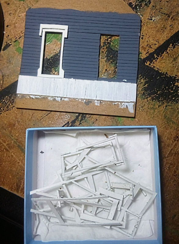

So I’ve moved on to the window trims. The main trim pieces are 3 layers thick and the headers are 6 layers.
All measured and drawn individually of course.

The lighter color under the darker color might work better if you thinned the darker paint some. The thinned darker color would not cover as well, maybe giving you the effect you are looking for.
Part of my problem is that I’m not 100% sold on the idea of weathering to begin with. Considering the fact that I won’t weather the trains I’m going to have to tread the thin line between reality and toy. [;)]. So elements of both worlds are necessary.
It looks good on the wainscoting but the blue gray siding looks better with a full coat of paint:
The wall on top left faces the track. The blank areas are for the bay window. The next step is to measure, cut and install narrow strips of cardstock inside the window, door and transom openings. The window panes and doors will be separate pieces.
