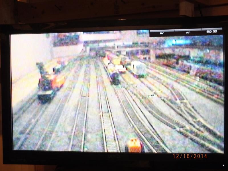

here are the two cams i use the key chain records video 30 min files then starts another. the one on the stand is a swann mini wireless camera thats hooked to my tv. i did have it setup to record on vcr then down loaded to a video program i had on an older desktop pc with a video in. that cam is 7/8"x7/8"x15/16" deep.
here is a crappy (sorry) pic of the tv screen og the yard. looks alot better in person.
