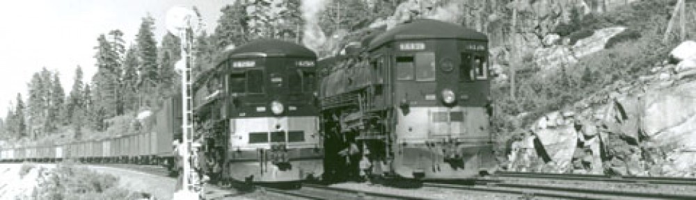

I noticed that the SP cut their rear helper engines in five or six cars ahead of the caboose. This differs from the PRR’s practice of cutting the helper in just ahead of the caboose, or simply coupling it directly on to the rear. I’m curious why that is.
Could it be perhaps that they didn’t want the “artillery fire” of the exhaust on the Cab-Forward blowing out the eardrums of the back end crew so they put it 200-250 feet in front of the caboose?
That’s probably a good guess. The whole point of the cab forward was to avoid smoking out the engine crew, so it makes sense that those in the caboose might get get a similar treatment (or at least attempt).
This is a bit of a stretch, but when they did the inaugural run up the Thompson River to Kamloops, beyond to Revelstoke, and thence on to Calgary, the crew of CPR 2816 were worried about the condition of the non-lined tunnels that hadn’t been exposed to the blast from steam locomotives’ exhaust in decades. The idea was that the exhaust would dislodge iffy rocks suspending in the ceiling of the tunnels. Fortunately, it didn’t happen…much.
So, with a much more powerful exhaust, and not knowing anything about the engineering of tunnels on the SP, could it be that the caboose denizens, when asked, stated they wouldn’t be averse to being towed a few filler cars behind these powerful locomotives…you know…just in case?
