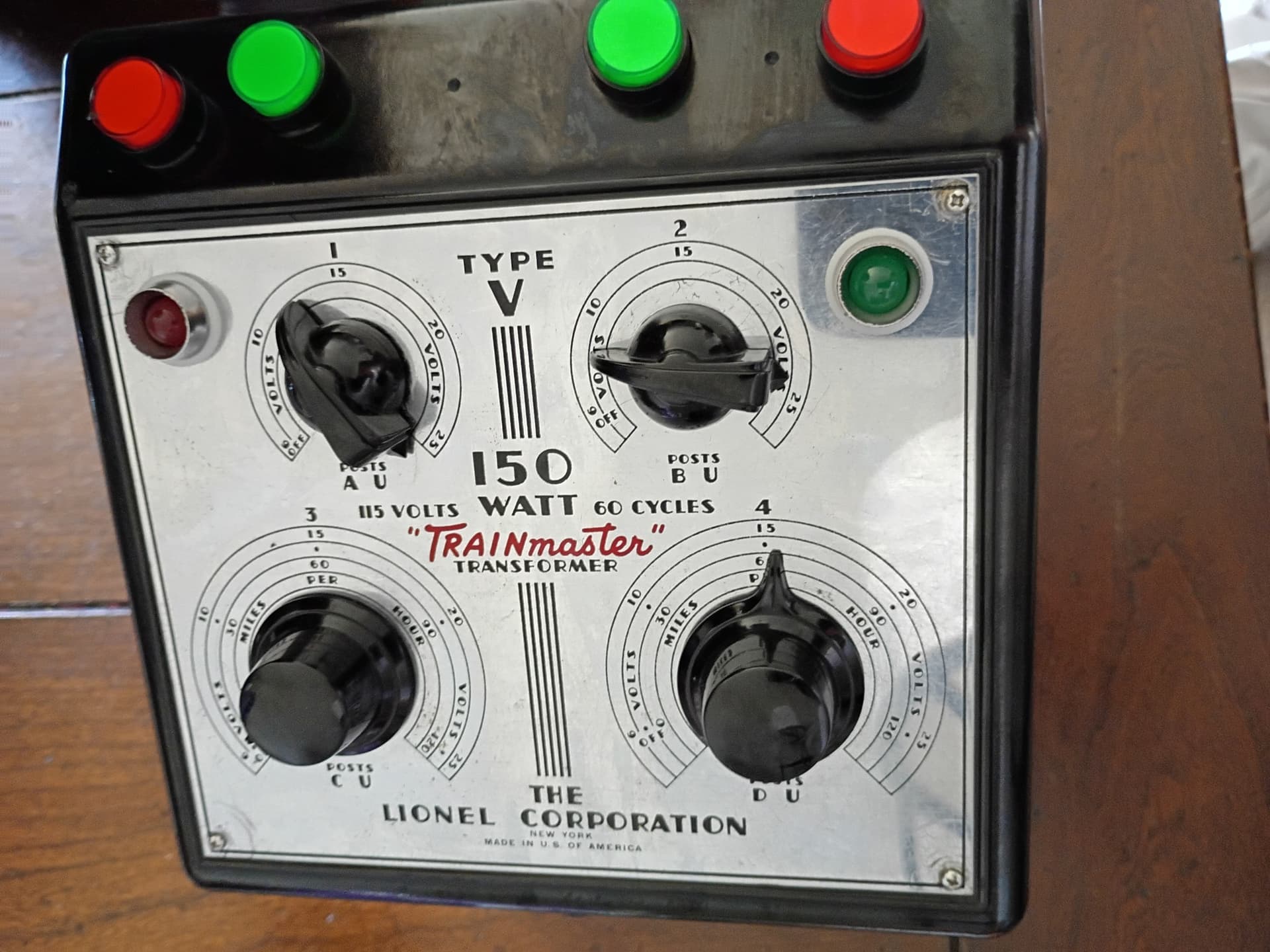

I would like to see pics of how that was done.
Lionel Type V
Refurbished and Upgraded with 2 whistle controls and 2 reverse controls.
New circuit breakers are installed and push button resets are on the back.
Your welcome!
Now that’s a super-slick job! And I love the Art Deco styling of that Type V, classic!
I use a Type V on my layout because I like how the “throttles” range all the way from near zero to high, so I can go between running Marx locos and Lionel postwar without any effort.
