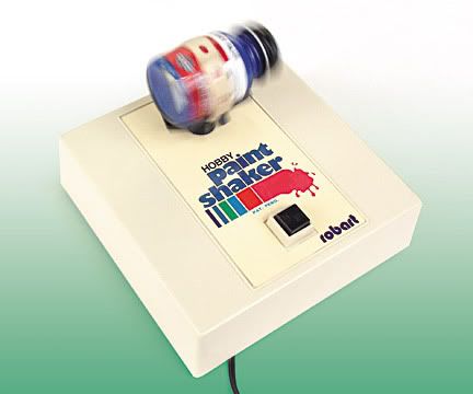

Who makes those little PAINT SHAKERS???

I’ll just chime in. I own the micro mark paint shaker and it does wear out after a while. The internal parts aren’t made for much extended use and the motor and/or the linkage will wear out. I don’t paint all that much either.

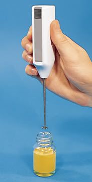

I have a little $3 stirrer like this one

Likewise, storing paint bottles in the inverted position is preferred as it tends to avoid the drying problem altogether. So, paints should be stirred, not shaken, before use. MircoMark and others sell a very nice little battery powered stirring device (cited above) for just this purpose.

Yes store your paint upside down. And I also have a paint shaker from Micromark.
I used it 1 time. If your paint is sitting for more then a few weeks then that paint shaker can shake it till it’s blown up a sub station and your paint will still be unshaken. I bought the Cordless Mixer. This thing will stir any paint, even if it settles on the bottom. It works great.
I have one of Micromarks littlepaint shakers and the noise it makes running drives me nuts.It is kind of like one of those Wagner power painters it buzzes all the time you are using it.The little battery operated paint stirrer is much faster and quieter. The BEST thing I have found is the vibrating shell cleaner from my reloading days. It may cost a little more but you can put ten or twelve bottles in it with medium and let it shake all night. I have walnut shells in mine right now. Just remember to put some clear packing tape over the labels , it will remove the lettering on them!

I just picked up a little battery operated one from Ikea yetserday for $3.99. Unfortunately the head is too large for the small bottles. It doe fit the 2 oz. bottles. I will try to cut the head off and fashion a small propeller from some scrap styrene. If that doesn’t work …oh well. It didn’t cost much.
if you cant get that prop to stay on just bend the rod in an L shape
like a hocky stick
just a brain fart
That’s a good idea. Why make it morecomplicated?

Like I said back on page one, a stirrer is easy to make.
A tube through a lid , another smaller tube through it and propeller soldered to the end. Attach to dremel on low speed and stir away. I have used this one for 10 years.
