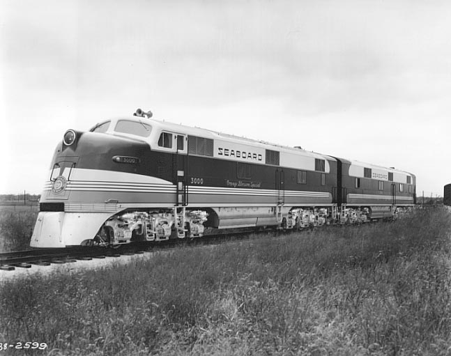

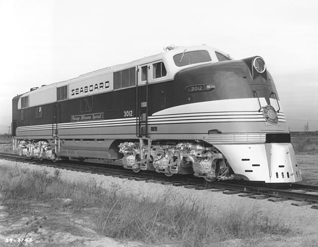

There is an excellent book published by the ACL & SCL Railroads Historical Society called “Orange Blossom Special - Florida’s Distinguished Winter Train” by Theodore Shrady and Arthur Waldrop, which details the history of the Orange Blossom Special. There are a number of photos of the Special behind steam and diesel, as well as some shots of the cars too.
http://www.northeast.railfan.net/images/sbd3012.jpg
http://www.northeast.railfan.net/images/sbd3000.jpg
http://ibistro.dos.state.fl.us/uhtbin/cgisirsi/x/x/0/5?library=PHOTO&item_type=PHOTOGRAPH&searchdata1=orange%20blossom%20special
Wow, lots of beautiful pictures there. Jackpot! Thanks a lot!
Ah, so that’s how he’s going down to Florida and losing his New York Blues. Makes perfect sense now. Thanks and I like your avatar.
