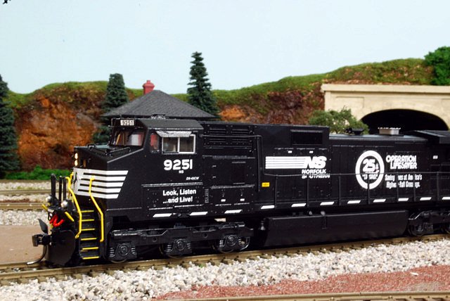

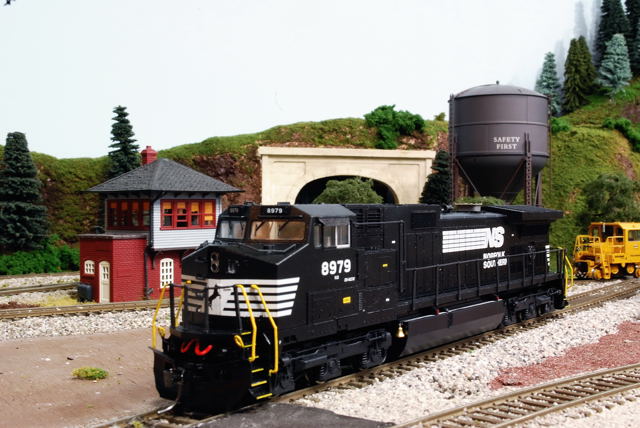

Okay, here’s a couple from me. First, two locomotives that the prototype never owned:
Both painted with rattle can spray paint bought at a big box store. (I think the black paint cost 97 cents)
This is just decals on an undecorated black shell. It represents a possible evolution of the paint scheme had the original railroad survived another fifteen years or so
Seems to have a Norfolk-Southerny-like cleanness. I could also see it evolving into a NS/CSX hybrid on later generations.

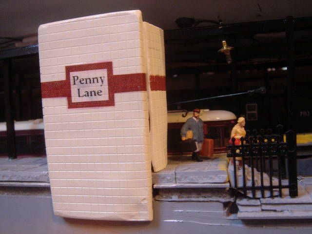

Just recently, I tried using decals to make stripes. In this case, it was for the pillars in this subway station:
I got much better results from the decals than I did trying to paint these lines. The decals were printed on my computer with an ink-jet, by the way.

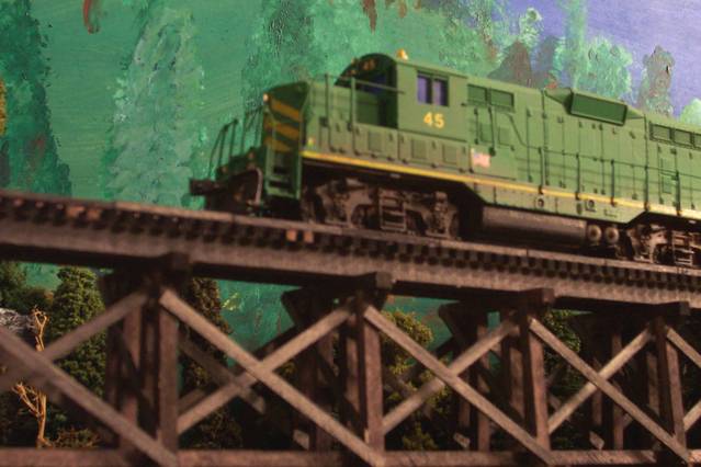

I have Russell Rail as my custom with BNSF as my main carrier in. Its nothing fancy but it does get some looks from time to time.
